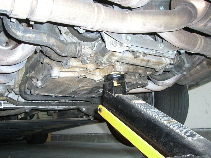

Try renntech.
http://www.renntech.org/forums/index...on-jackstands/
Edit: get front on stands and then lift rear from here:

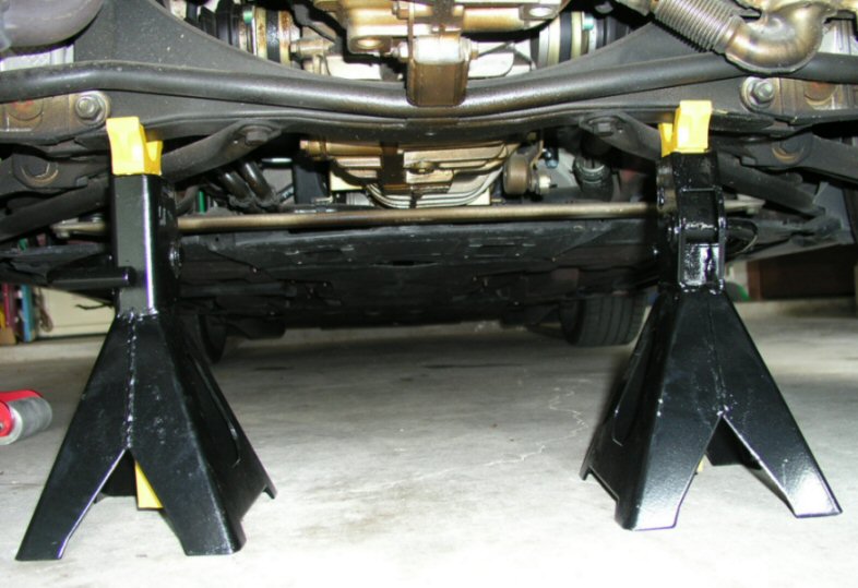

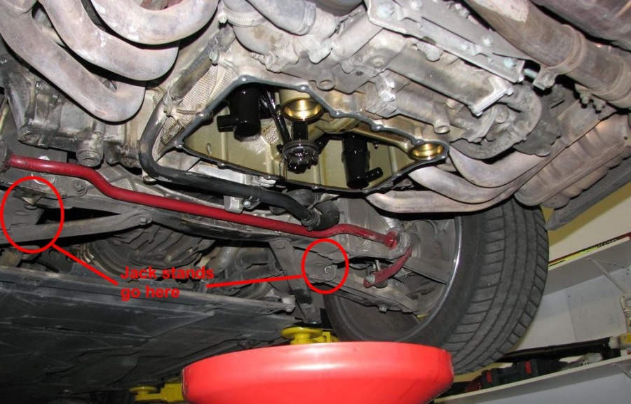

Or lift from factory mounting spots and put the jackstands on the cross brace or frame mounting points as shown below [I put mine on the red circles. There are two holes in this beam, just put the stand right between them].

This works great.......jack up from normal rear positions, place fronts then put rear stands here as shown.
