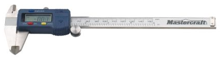

Why not use something like this... It may not be quite as accurate as a micrometer, but it should get you close enough for a caliper measurement.
... and they're pretty cheap ($40).

If you're going to use calipers as pictured above you'll need to pick up a set of caliper accessories/tools to allow measurement of calipers. The attachments allow you to "reach around" the lip of the caliper to measure the center thickness. You can pick up the attachment/accessories from www.mcmaster.com

Cool, thanks for the information. My problem with using a caliper is, like you said, reaching around the lip, so if I can get an accessory to get around that, then that would solve my problem. I'll check out the McMaster.com site.

Zero the tool with two dimes in between, then put a dime on each side of the caliper and measure. Simple fix - still reasonably accurate.
