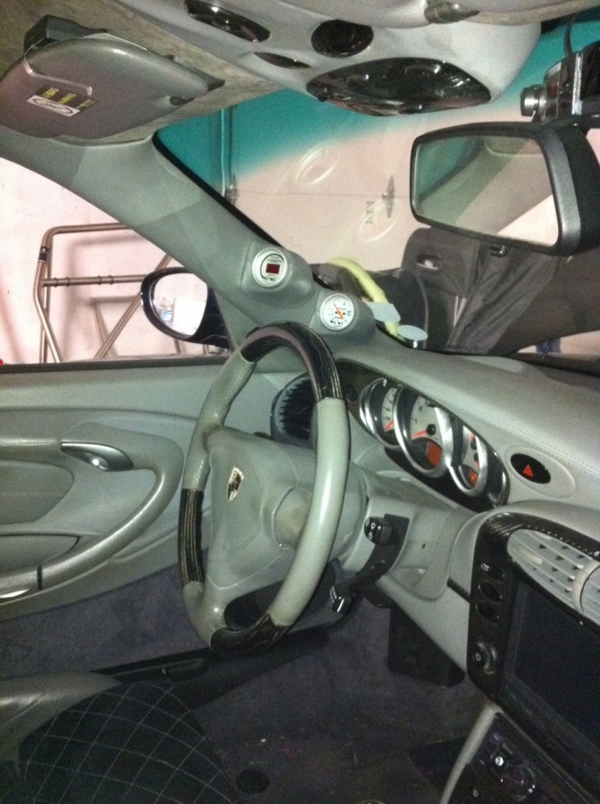

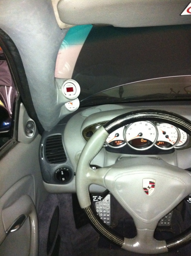

So I got my a-pillar back from the upholstery shop and it came out great. Took the time to dye it with the color match I had before from the GT3 seats, and it looked even better!
Tonight I installed it in the car with the gauges. Personally, given the fact that you're trying to add gauges in a car and make it look as stock as possible, I like the result!
I'm sure there will be some out there that hate it... anyways, here are some pics...
With that done, I can now move on to put all the interior back together and get into some much needed cleanup of the car and the garage!
Cheers
Aaron
