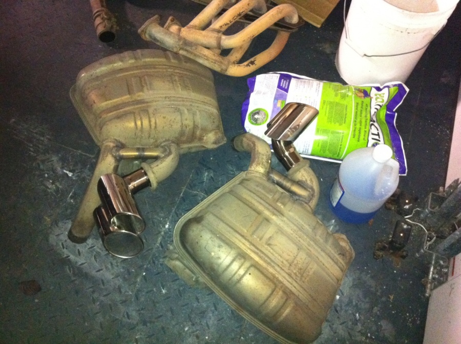

Well I got the rest of the exhaust off today and started in on the spark plugs, tubes, and coils.
The bugger thing is those spark plug tubes. I tried the boat transom plug idea, but that did not work at all. I think there is a removal tool out there for them...
So for today, looks like I'm stuck until I can source a tool tomorrow...

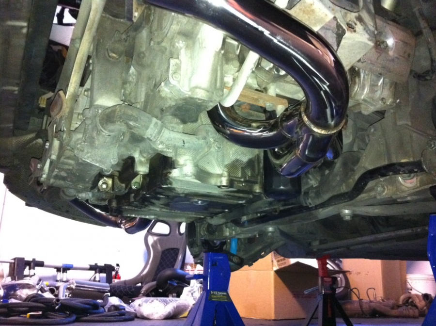

Well fairly productive day considering all the other things I had to do and that I had dinner plans.
Anyways, I finished the plugs, coils, and tubes on the other side. Also changed the fog and city lights, I know not SC related but was on my list.
Also put the new headers on as I remember an old saying that you shouldn't leave headers off the car too long. I also need to line up the bung placement for an O2 sensor for an AFR gauge.
Going to start on the water pump and thermostat next week...

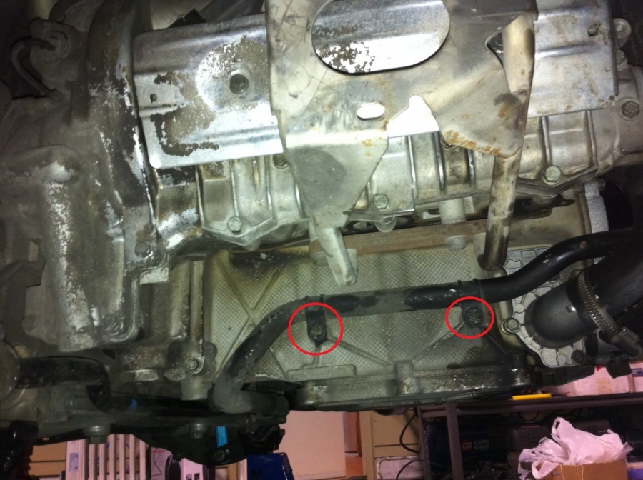

Well I got the water pump and thermostat replaced today. If you follow on Renntech at all, there was a discussion about IMS, RMS, and cracked head failures on the 996 engines. Jake Raby was saying that he has seen the plastic sprockets fail on the water pumps and the pieces causing cracked heads. His recommendation was to replace the water pumps every 3-4 years.
Anyways, I am a preventative maintenance sort of guy so since it is all apart now, I did it. Lucky I did, it was the factory original pump and the cooling fans were fully intact, but very brittle. They broke right off when I was checking it out after it was off. Dodged a bullet there...
I used the following instructions: http://p-car.com/996/diy/waterpump/
I'd like to add a few points though... First, no matter what you think, the water pump is removed through the bottom. NOT the top, don't bother trying even though it looks like a smart idea.
Also, to do the thermostat and to remove/replace the water pump, it is much easier to loosen a cooling line that is bolted by two bolts behind the headers on the driver's side. Once these bolts are out, you can get at the thermostat bolts with an extension and the water pump is much easier to clear in and out. I've attached a picture for reference.
I was going to start in on the injectors today, but got a little tired. Will focus on that this coming week... I also have a full set of new coolant hoses coming as a few of mine are looking about ready to replace, so if those come in I'll be doing that as well.
