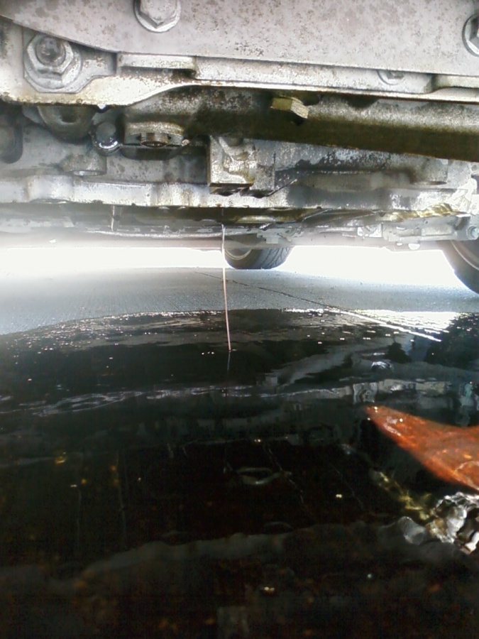

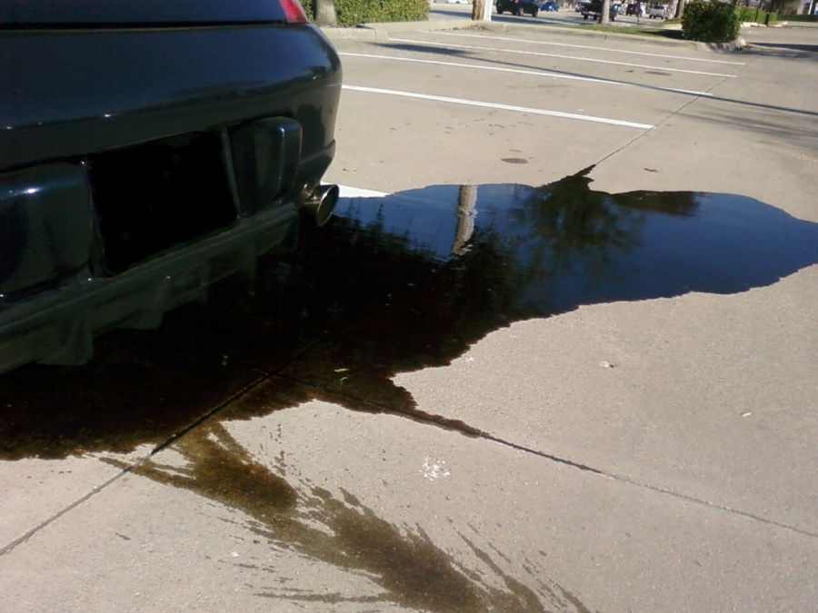

my car took a dump on Sunday after I drove over a speedbumps..All I heard was a clunk & about 30 sec later out come 9 qts..I bought one of those magnetic drain plug & it sticks out about 1/4 inch instead flush to the pan like the oem plug. when it hit the speedbumps. it shove the drain plug right up the pan & ripped a big hole..had to towed it to Rac Performance waiting for a new pan...I was so p/o at myself but what can you do..just bad luck I guess.

I thought about upgrading it to the X51 pan but he said it will sit even lower than the oem pan..He also mention if I don't track my car..which I don't then I shouldn't need it.
CORRECTION...I did upgraded to the X51 oil pan..he thought I wanted the extender to the pan which sits lower .

thanks...I might look into that KW...I think the main cause was the drain plug was sticking out so far down..going back to stock this time.
