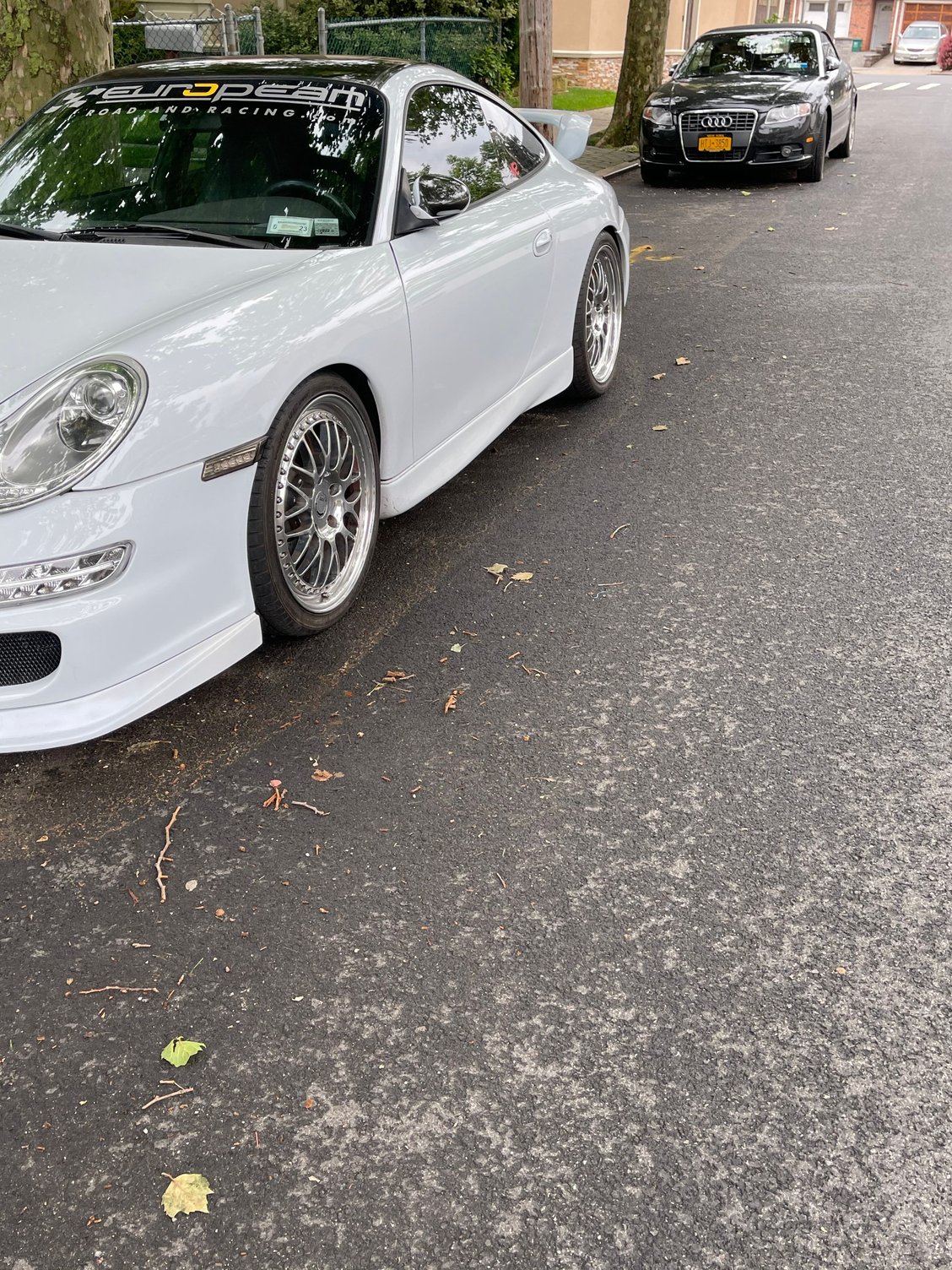

This was my ride as I bought it a month ago aggressive ride height and 19x12 rears to boy racer for me zero rubbing

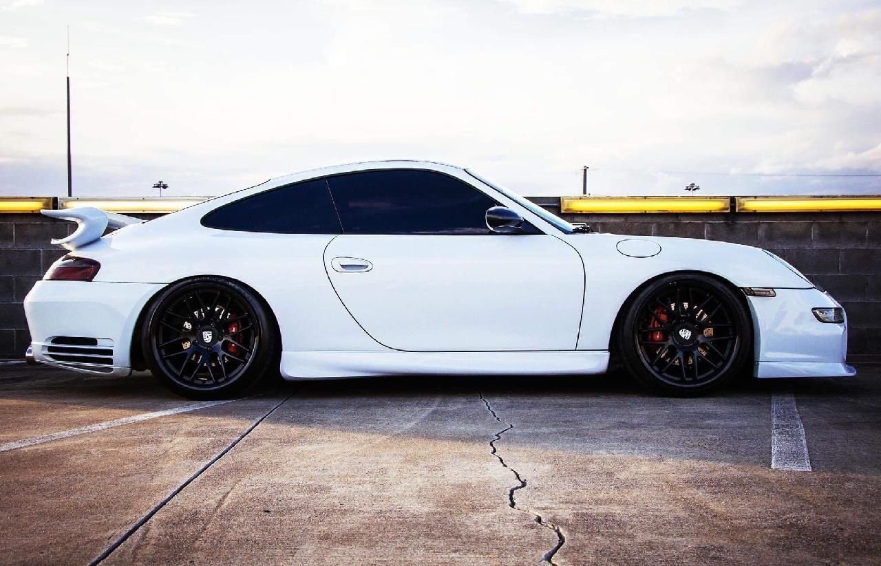

This is adjusted ride height for NYC street’s potholes and perfect fitment 19x10.5 rears by HRE 540r 285/30/19
