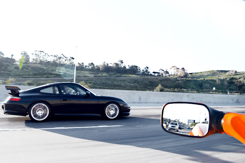

hot damn....Tony's GT3. Nice ride height...

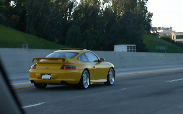

Okay Arling, I'd like it to be this low...

LOW RIDER!!!
