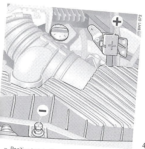

Did you try this?

[QUOTE=bbywu;3236955]Did you try this?
<snip>
Thanks, yeah the red terminal appears to be missing in my (rather heavily modified) model. But I've read that it can sometimes be somewhat difficult to extract, so I'm going to take a closer gander. Thanks for the idea and photos!
