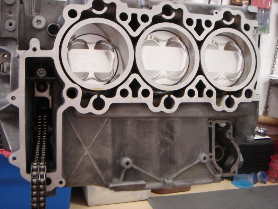

Rebuild before you boost:

Well our suggestion would be something like this!

You are right the AWD somewhat numbs the driving feel, but there is a reason Porsche uses a different engine for the Turbo. The GT2 has a much nimbler driving experience. The 2002 & later 3.6 M96 crankcase is much stronger than the 3.4 that's why I posted that you should install stronger cylinder sleeves before boosting cylinder pressure.
