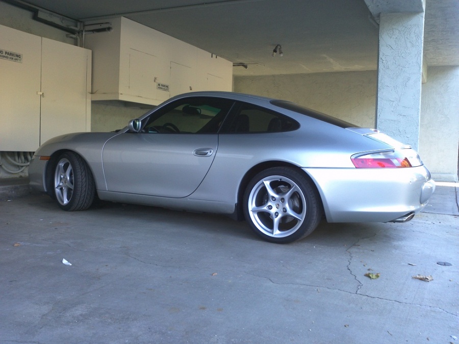

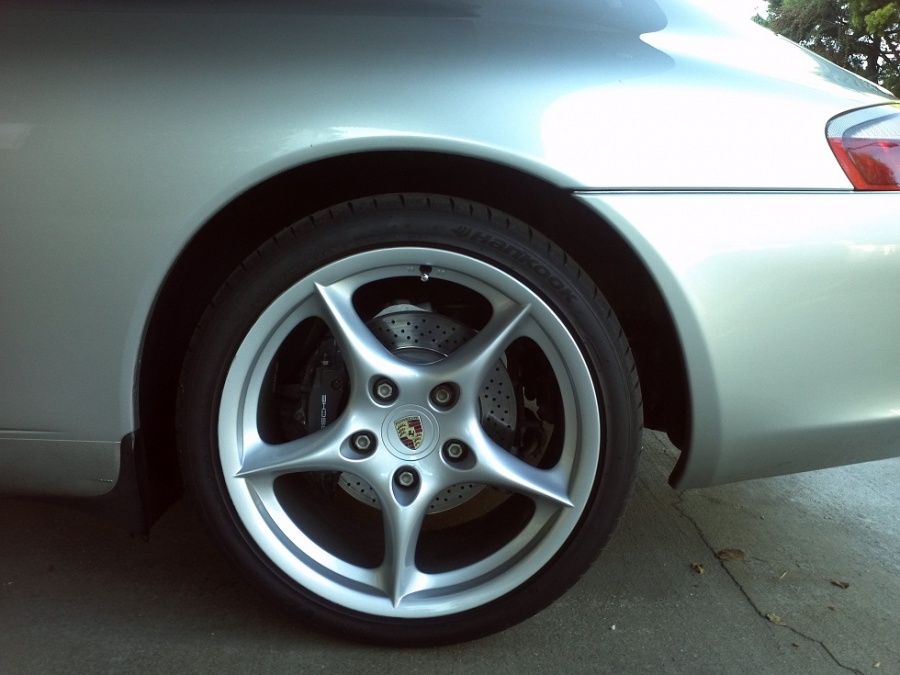

I like the feel of this setup, but I'm surprised at how much of a rear gap still exists. I put on nearly 1,000 miles and 2 track days since the install, so they should be well settled. Could there be a mistake in the install or is this just the gap with ROW on a MKII?

thats normal, the Row M030 does not drop the car much, did you get it aligned since the install?

Hopefully, it will eventually settle, and drop a bit more. I believe it is more about time, and not mileage. My 99MK1 came with Row M030 from factory. Currently, the rear gap (tire to fender) is about 1.5" or two fingers, and the front is about 1.75" or two and one half fingers. Your PICs do imply you have a way to go. Good luck.

Much appreciated. I thought it would drop about 20mm (~1") in the front and back but the rear looks almost higher than stock!

Perhaps the stock rears settled over time so the new ones appear higher. The fronts look great though.

The ROW suspensio lowers the car about a quarter to one half inch. The X74 suspension lowers the car about one and a quarter inches.

Judging by the height, you have the American M030 suspension. The ROW M030 Suspension drops the car a minimum of 1". I know, I have it and it is a perfect ride height.

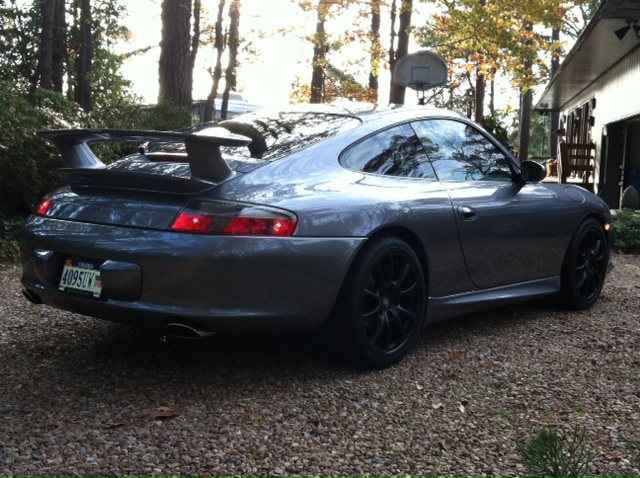

I have this with GT3 wheels. Installed 09/2010 000-044-500-27 ROW M030. I could see that lower would look better but I am very happy with the street ability of this suspension.

99Jules: let's see your car! I still haven't gotten my alignment, but found a local shop that caters to track junkies and HPDE enthusiasts, so I'll post their recommendations after I visit.
Bella1: thanks for posting the pictures. Those were the best comparison shots I've seen and I can tell that my ride height is similar.
