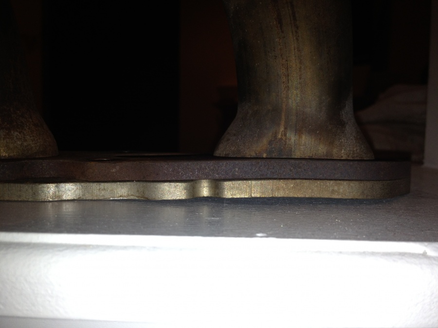

Hi, i am thinking to change my drivers side headers on my c4 3.6L 2003, question is if 997 headers can fit on mine if not which is the best after market?
(mine is bent so i wanted to try upgrading since i have to change )

[quote=996C4SPfaff;3453801]I dun understand why are you planning only change one side either.[/quote
the header has a flat surface mounts to the engine with 6 bolts and the surface is a bit bent ...ugly sound...

If the header is just a little warped, you could also just have a machine shop put a new surface on it. That way it will be flat and bolt right back up. Be sure to replace the bolts.

Changing only one header will make each head perform differently. Not recommended. Pushing air out of the combustion chamber will change for the head with the new header. Meaning the head with the stock header on it will be a bit slower in expelling the used gases. You want the engine to perform equal on both sides. This would be something I would only do on a old mustang or something. I have Fabspeed and love them. My exhaust tone is much different than most 996's. The cheapest thing to do is to take it to a machine shop and have them resurface it. Maybe $100 at the most. Maybe an hour of work. And yes new bolts are a must or else you'll be hating yourself later when a stud gets stuck or breaks off. Good luck.
Thanks, there is a used Header found the guy is asking $150 for it..now its a good idea to machine it and make it flat(is it 100% going to be flat with no leak??) or just replace the bent one with the used one...

I guess I don't understand why you can't use your old header and re-surface it. Things tend to bend under pressure and temp. Whats up with your header and why can't you reuse it?
im worried about flatting this since the bent is on the side not in the middle
