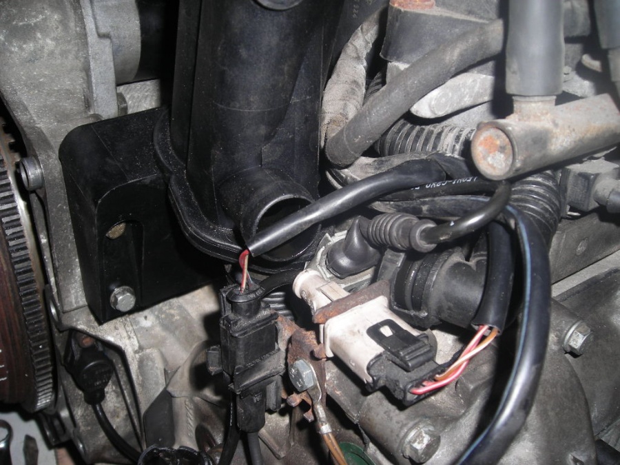

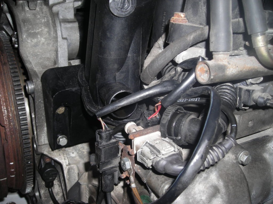

mystery solved
as it turns out , it the first time i ever see this on a german car, the electrical connector are set so that they cannot be mixed , but i was wrong , the whole engine harness was taken out so its a little bit more involved then just swaping one sensor
have a look at the picture , which one is right ?
Old Jul 6, 2012 | 05:36 AM
rb101's Avatar
Joined: Sep 2010
Posts: 37
From: Sanford NC
rb101 is a splendid one to beholdrb101 is a splendid one to beholdrb101 is a splendid one to beholdrb101 is a splendid one to beholdrb101 is a splendid one to beholdrb101 is a splendid one to beholdrb101 is a splendid one to behold
per the 99 wiring it should be white and brown wires.
