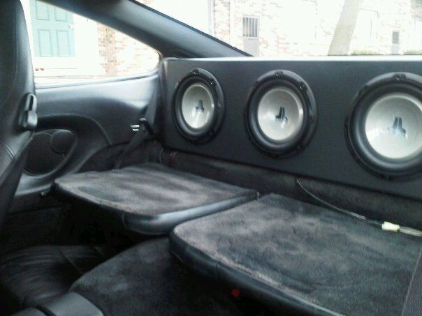

I have 6" JL Audio Evolutions in my dash and 6.5" JL Audio Evolutions in my doors, backed up with a JL Audio 500.5 Amp and 3 JL Audio 8" Subs.

Stephan_Porsche, how did you put 6" speakers in the dash, and 6.5" in the door? Did you do a lot of cutting and customization (I'm guessing, yes).
Thanks everyone!
