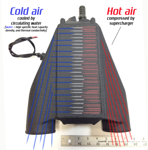

Illustration of air intake path through our custom Air:water Aftercooler

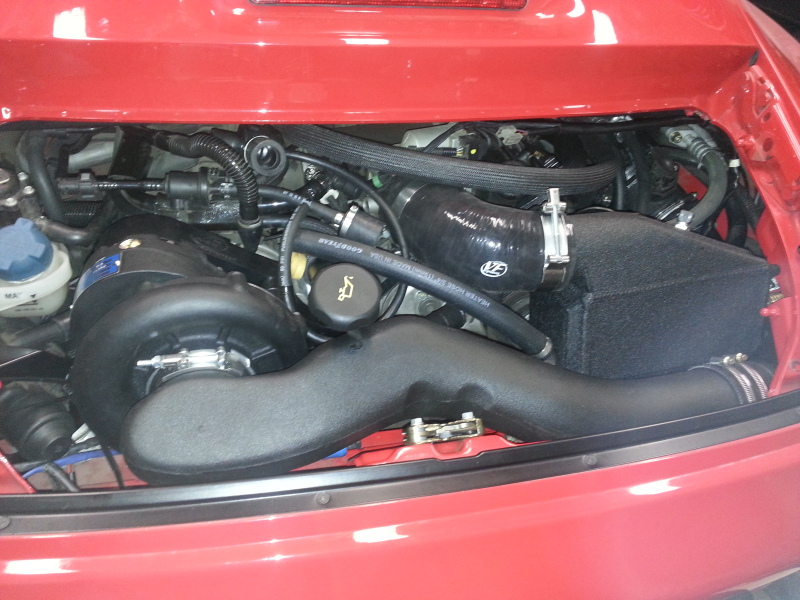

Just finished my install two nights ago!! Wasn't that bad at all. Especially when you can look back on this board and see previous installs. So thanks to Justatoy, Purplxed, and DouginKC, it went pretty smooth. I just started her up and went around the block a couple times and so far so good. Gotta get past my break in period and then let her go!
I would say I spent ~ 20-25 hrs doing this install.
Injectors were kinda tough, you can do it without lowering the engine.
I used a "drill pump" to fill the charge cooler system and get all the air bubbles out.
I thought toughest part was fitting the S/C on and getting alternator lined up so the bolt will fit through. Then you have very little space to tighten up that bolt.
But I feel so good that I was able to accomplish this.

Not many pics.
I live about 20 mins from VF so I dropped it off on a friday and picked it up on the following Wednesday.
test fit all the parts, I had to trim the silicone pipe 90 that connects the charge cooler and the throttle body, make sure the charge cooler right corner will fit low enough and over enough to let the right engine lid shock to clear when the lid closes.

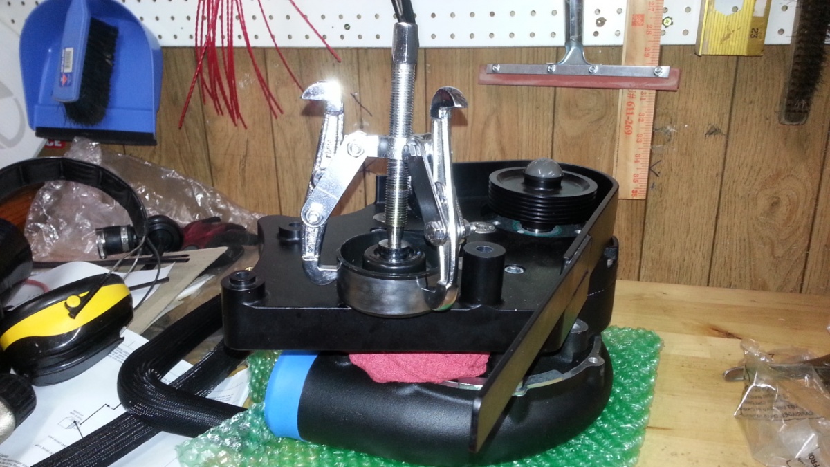

@trisgale

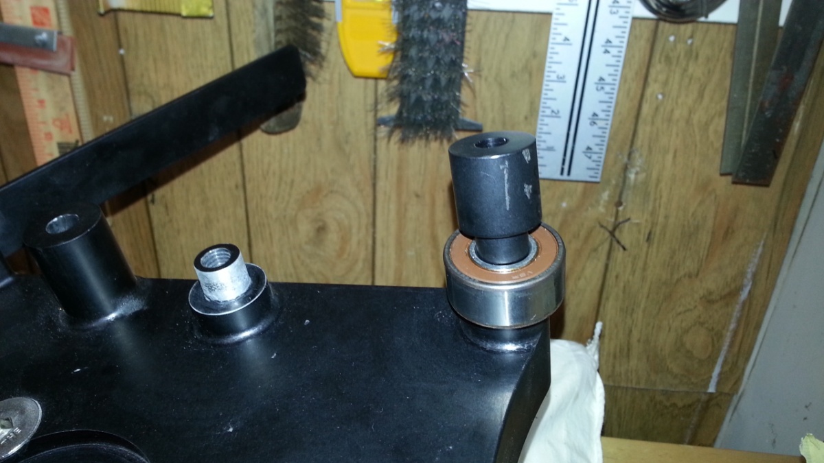

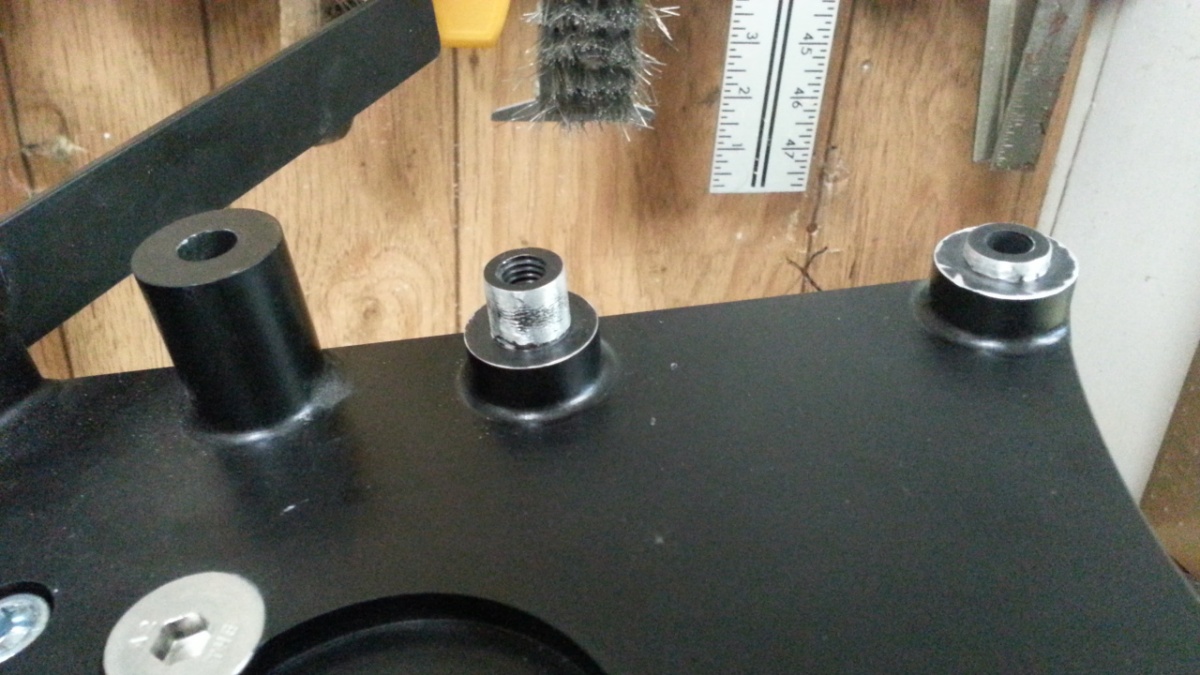

I see you also have the all-black supercharger. Did you have to remove the black, anodized paint from the SC shafts and spacers (like I'm having to do)?
How's it running? Did you install one step cooler spark plugs?
ID:	228693   Click image for larger version

Originally Posted by trisgale
i got a press to get them on, i didn't remove the black powder coat/ or paint. It was a tight fit.
I tried to press them on too, but failed miserably, and ruined a perfectly good pulley and brand new bearing from VXB.com. I had to drill three holes into the side of the pulley and yank it out with pullers! Jeff over at VF said to "sand" off the black anodized paint... right... more like take a steel file to it, and pray you don't take too much off! As you can see in my photo above, I have just the spacer left to do -- this is not how I'd prefer to spend 45 minutes Perhaps this thread will help future customers. More photos and info here:
http://doug996inkc.blogspot.com/2013...ger-shaft.html
Frustration aside, I'm glad to hear it's providing you a lot of enjoyment. I'm looking forward to finishing my install this month.
