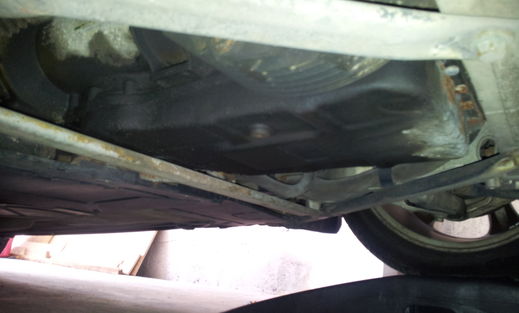

Hi guys. When I got this 99 Carrera, I had no clue whatsoever that it is more difficult to DIY certain important stuffs concerning the engine because the engine is in the rear part
Unlike my Cayenne turbo, it's engine is in the normal location
I was able to buy a ramp so that I can ID and inspect the vehicle. I have to admit I am a little disappointed to discover these oil leaks. I didn't see them when I was buying the car
There are basically 3 areas where oil is leaking. Please help me identify which parts they are and what sort of repairs are needed. Here are the pictures...

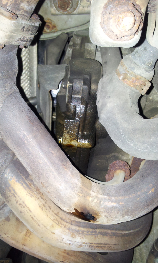

This one is on top of the exhaust pipe on the left side...

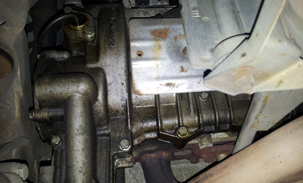

This one is in the back middle part near/adjacent to the oil filter...

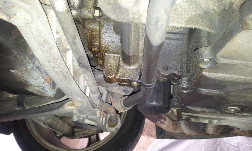

This one is towards the center of the car. I notice that oil is not to wet here...
QUESTIONS:
1. Where are these leakis coming from? Both engine and tranny are leaking?
2. Are these oil leaks serious or are they part of a normal wear and tear thing?
3. Are these the type of gaskets I need and price range I'm looking at...http://www.ebay.com/itm/Genuine-Engi...869bd8&vxp=mtr
4. Considering that this vehicle is an oldy (13 years), I'm assuming that this type of gasket replacement is necessary right? SO no serious issues t worry about what caused the leaks right? (wishful thinking
5. Going to the stealers is not an option because my C2 is a grey market import from the US - unfortunately the local Porsche dealership DOES NOT DO grey import servicing. Unlike my Cayenne 04 which was locally purchased, I get charged 2 arms and 2 legs everytime I bring it in for anything. With the C2, I don't mind going to other repair shops. TIA for the help!

Looks like the RMS and Transmission gasket.
QUESTIONS:
RMS and Trans gasket.
I would say normal, RMS was a 996 problem especially if the car was not driven a lot. Replace and be done.
Link not working, you can get online at several places so long as the shop will install customer provided stuff.
Again I would say no serious issue. If you replace them and it comes back (which it shouldn't) then look for underlying issue.
Yup, find a good indy and you'll save moola.

While FLA996TT is almost certainly correct in diagnosing the RMS seal, there is a *small* chance that it could be the IMS bearing. It is pretty much impossible to tell which unless you drop the tranny.
If it is the IMS, you want to have that dealt with PDQ.

The oil drop dripping on the header(exhaust manifold) seems typical with leaky spark plug tube/o-rings.
I would replace all spark plugs and inspect coil plugs for cracking and inspect and/or replace all 6 spark plug tubes along with o-rings. This is pretty common issue on older 996 models.

Header-side leak
As stated,it could be the spark plug tubes. How i knew it was mine,It would only leak after about a few minutes of driving then i would get some light smoke coming from the back. Changed them myself,it's not too bad of a job,there's a great DIY on Renntech.
