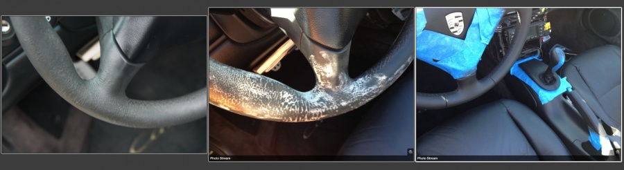

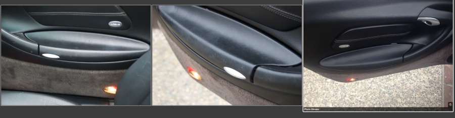

So I finally got around to looking at my car's interior. It's a 2000 C2 cab with black leather and was desperately in need of some TLC.
First up was leather restoration. It was dried out (top left down outside a lot), scratched (kids!) and generally looked like cr@p.
I used the kit from Leather World Technologies http://www.leatherworldtech.com. Reasonably cheap, comes with everything you need and it's easy - You clean, scruff, sand, fill, stain, stain, stain, stain, buff and polish. All simple if you are patient and don't rush.
The results are really good. I used the matt finsih, and if I did it again I may pick the semi-gloss but it really does make the car look new again.
I attached some pics - left (before), middle (during), right (after).
Cheers, Alan
I'm also doing some trim painting (standard black to arctic silver) - will post that once it's done.
