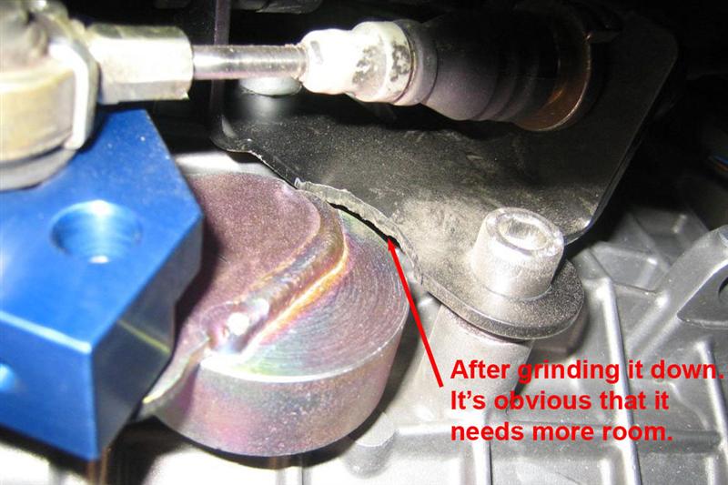

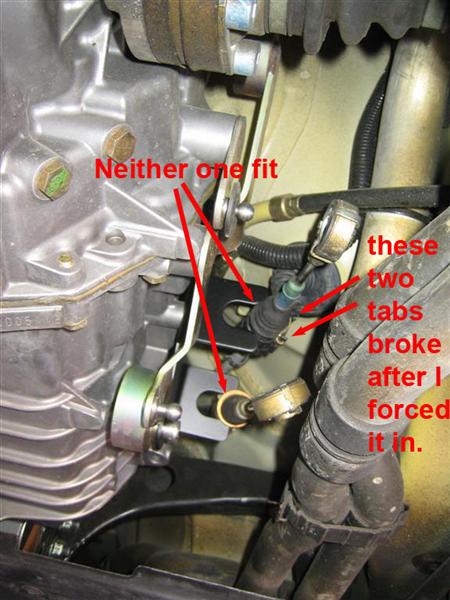

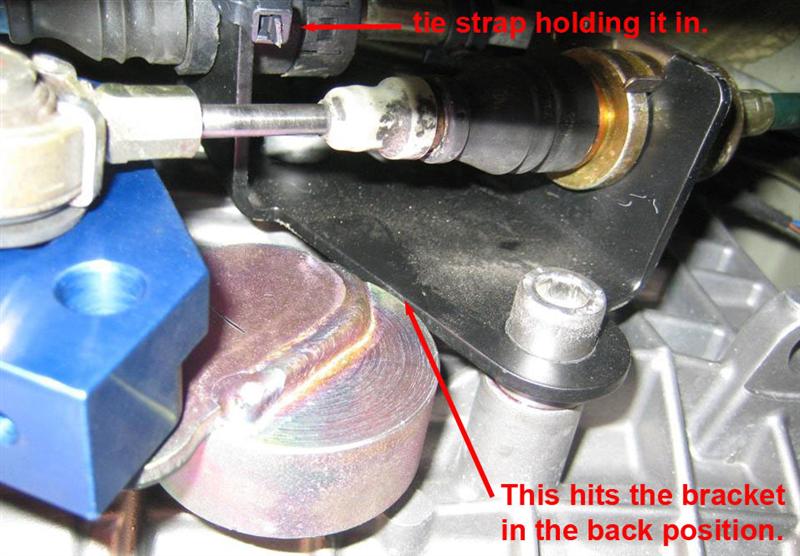

I have a 03 C4S. I ordered a B&M undercar SSK and installed it. It should have been a 30 minutes install turned into a 2 hours install. The new bracket that came with the kit bolts in fine but the slot that the cable hold slides into is just a tad too small at the opening. Made me break the plastic tabs that holds the cable hold in the bracket after forcing it in. The metal one just refuse to go in. I decided to use a caliper to measure it. The opening is too small!! I have to use tie strap to temperarily hold the plastic one in place and grind the bottom one bigger. Then it slides right in and lock into place.
After everything is finished, I noticed that the weights will hit the bracket. That means whenever I used 2,4,6th the weight will hit. As a perfectiionist, I decided to grind a dent into the bracket.

more pics
this shows that they will touch.
Old Jul 5, 2005 | 07:23 AM
Alexcwt's Avatar
Joined: May 2004
Posts: 205
From: Dallas, TX
Alexcwt is infamous around these parts
after grinding
This shows after grinding.

I think it's just fault in manufacturing
If someone else install them, they won't care if something hits when your using it. Like I said, I'm just a perfectionist. The bracket in the picture in the instruction has a similar opening to the factory one. It flares out at the mouth. The one I got is straight. I think the boxter unit will not have this problem because the cable holder should be the same as our car.

Too late when I notice
By the time I realize that it's the wrong size. I already forced the plastic one in. I might do more damage on the way out. It won't fit back on the factory bracket. That means I won't have a car to drive. So I wanted to have a replacement part before I do anything else. I figure it was a little bit of grinding anyway. So I ground away 2 little tabs at the mouth.
