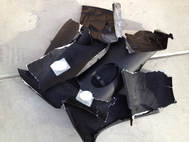

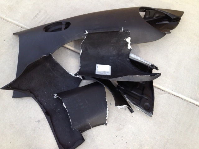

I personally do not recommend the "FRP" fenders. I went this route to save time and a little $$$. Waste of time and $$$. There is really very little to no cost savings. Having the fenders welded is easy, or you can buy metal fenders and tub rails already done for $4,000-$5,000.

Here is a couple pics of the FRP fenders that I ordered and did not use!
