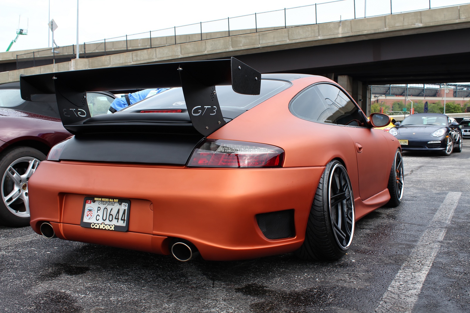

Is something like this what you have in mind, or maybe not quite so low?

The fronts look good to me on that car, but the rears are a bit too much. I would want to run less camber and the wheel sticks out a bit too much.
