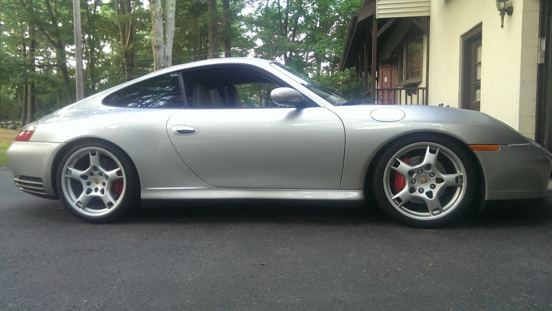

Hi Blown,
my avatar is a pict of my C4S with H&R. I am running 18" with 36mm offset in the rear, and they fit flush with no rubbing. I think with 20" with wider tires and spacers, it will rub. I would also suggest you look into getting rear toe links and dog bones. Because with the H&R your rear alignment cannot be adjusted to porsche alignment spec, and you will wear your inner part of your rear tires very quickly. I have installed those this year, and it makes a difference in the handling.

Old Sep 17, 2013 | 06:46 AM
FLA996TT's Avatar
Joined: Apr 2012
Posts: 1,850
From: Brandon, Florida
Rep Power: 183
FLA996TT Is a GOD !FLA996TT Is a GOD !FLA996TT Is a GOD !FLA996TT Is a GOD !FLA996TT Is a GOD !FLA996TT Is a GOD !FLA996TT Is a GOD !FLA996TT Is a GOD !FLA996TT Is a GOD !FLA996TT Is a GOD !FLA996TT Is a GOD !
Toe links and dog bones are a good idea, however, Porsche recommends 2* of toe out, when you lower it remove some of that toe out.

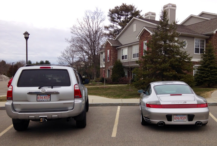

My avatar has mine with H&R springs. I have 19's on right now. I may go back to my 18's at some point though.

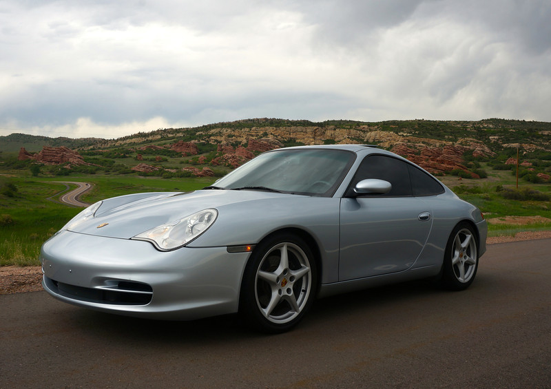

May I suggest going OEM, but RoW spec? Here is mine with 18s (roads suck too much to consider going to a larger rim)...

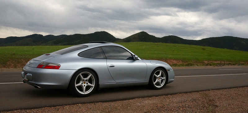

I don't have H&R lowering springs, but PO lowered my C4S with the PSS10 system. I love how it looks and I am told (though I cannot verify) it rides better than stock. Same color as your C4S, this might give you an idea
