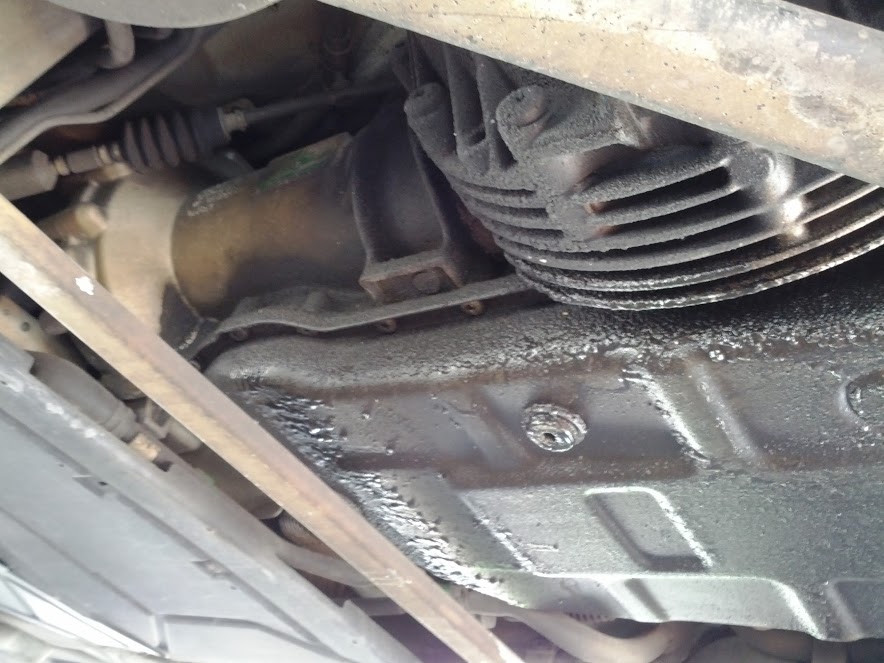

Did it look like this?

Jay, Yes, this is exactly what it looked like before I cleaned it. Now, it has a thin film of ATF covering it, along with a couple of drips. Have you determined the what the source of the leakage is and what the fix would be?
Old Mar 14, 2014 | 08:37 AM
jayi836's Avatar
Joined: Dec 2010
Posts: 426
From: Simi Valley,CA
Rep Power: 34
jayi836 is infamous around these partsjayi836 is infamous around these parts

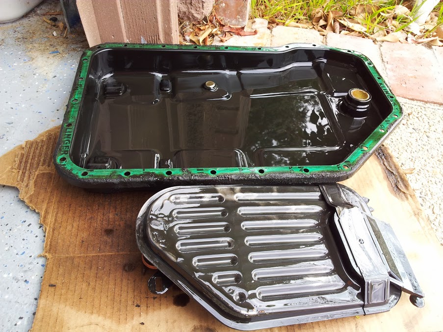

I took it to a independent Porsche shop for a diagnosis, like your case the entire underside covered in gunk. leaking cam seal and spark plug tube O ring. The transmission they explained was sweating fluid. normal for 80K. New gasket filter and fluid did the trick a year ago.
After you drain the fluid you may want to change it every 30K instead of 90K. I actually changed it twice at 80K. The second time a week later, i couldn't find a fluid exchange procedure like other cars have by disconnecting one of the hoses at the tranny cooler.
This may be in my head but the shifts are much quicker and smoother now, especially down shifts.
The new fluid is the golden color like fresh motor oil, the last owner had it done at 54K I hate to see what it looks like at 90K.

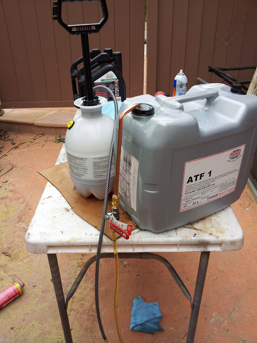

Jay, did you make the changes of fluid, filter and gasket yourself or did the indie do it? Either way did you use Porsche ATF or would any high quality ATF work? If you made the change, how did you fill the new fluid? Bentley manual shows special filler tool. Like I'm finding out, the P-car service is more difficult then it needs to be . . . damn. Thanks for your input on this issue! Larry

Larry,

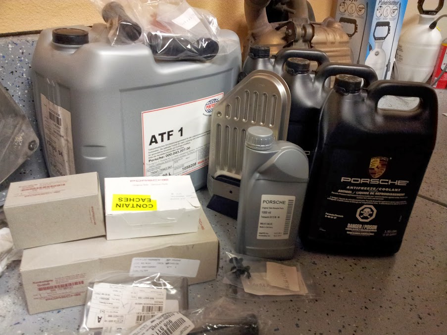

All services are extremely easy to perform, you can PM or call if you need help. Rentech has an ATF DIY I followed.Purchased everything from Sunset Porsche in Oregon. the ATF is on amazon a bit cheaper.
This is the pump I made.
My gift from Sunset

Thanks for all the great info. The Rentech DIY was just what I needed . . . should save me 200-300 bucks . . . that, friends, makes my lovely wife very happy and helps with retirement income.
