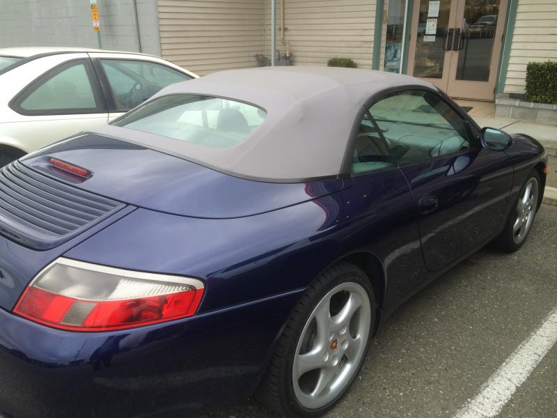

Old top:
New top:
You can see how the old top color lightened considerably. What you can't see well is the wear caused by scrubbing and power washing.

Originally Posted by roadsession
what top did you buy and from where...and what did it cost you...did they reuse your headliner and glass?
I spoke to a bunch of places local to me (there are three recommended upholstery places that all advertise in the local Porsche Club of America magazine) and got quotes ranging between $1500 and $2k. The glass and headliner were reused. I initially thought that the headliner might need replacing because it looked like it had some tears when I inspected it while the top was in its service position. However, the shop owner told me that some cuts/tears are actually part of the design for folding. My headliner did need to re-stitching and some new velcro since the driver's side rear had detached from the frame.
The lowest cost place would have me order the top online and have it drop shipped to them. As a result, they would warrant the work but not the top since that would be through the seller of the top. The most expensive place wanted a week to do the work. The place I chose that was closest to me, recommended by my local indy and detail shop, does lots of work for Barrier Porsche (across the street). They used a GAHH top and did the work in two days. The top must not be opened for two weeks so that the fabric can stretch. With tax, the total was about $2150 and both the top and the installation are covered by the warranty. As part of the top installation, they also tune up the mechanism and I've noticed fewer creaks and rattles in the 2 hours I've had the car back. Link to their website: http://www.sunmarkup.com
