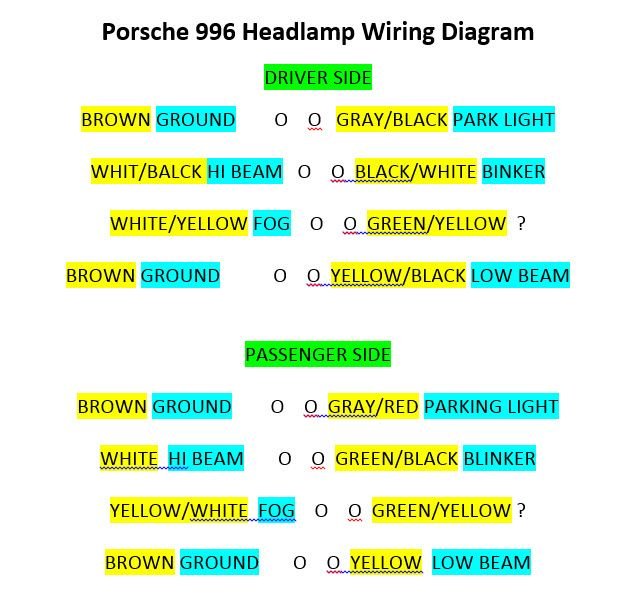

Hello all:
So i have just completed a 996 to 997 steel conversion at Denver Auto Body & Paint in Denver, CO. I used all OEM steel 997 parts.
I wanted to pass on the wiring diagram for the headlamps with the details from Precision Porsche.
My diagram is all 996. You just need to wire up # 11 yellow and black wire and # 12 ground (brown wire) this is the low bean
for the hi beam they show the same # 12 for ground and the white with black strip is the power. this is all i would hook up for the left side. this will operate the head light. you will need to run wires to hook up the front bumper lights. send me pictures of the bumper light also. so i know which bumper lights you are hooking up and i can help you.
for the right side
# 11 solid yellow and # 12 thick brown wire low bean
# 4 ls solid white wire and #12 think brown.
from the look of the wiring harness you sent me, you will only have to hook up the thick brown wire #12 and that should work both hi and low beam.

Here is the 996 and 997 wiring diagram from the Porsche technical guide.

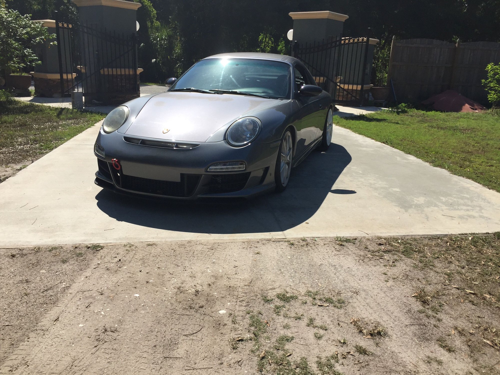

Here is the 996 I purchased next to the 997 it has become.

Turned out nice and you probably saved some dough in the process.
I figured it was a 50/50 as far as the fenders based on the bondo pics but didn't want to assume.
Is it safe to assume you kept your 996 fuel filler door/neck assembly? Seems like the cut is just in front of it from the pics.
