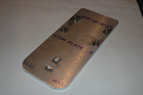

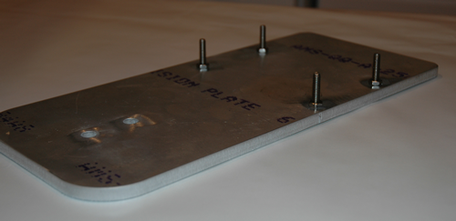

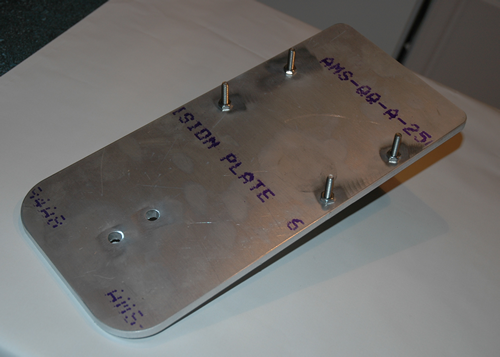

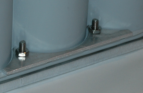

Finally!...after several cuts on the Laser machine and many minor adjustmens to get all the holes properly aligned, here is the final product. In the end, the four small holes for the studs that hold the battery down had to be drilled using a drill press becuse the laser machine could not cleanly blow through the 3/8" thick aluminum in with such a small radius. So, we programmed the laser machine to etch a crosshair on the plate and then hand drilled the holes for the studs. The plate is high grade T60/61 aircraft aluminum, and the studs, nuts and lock washers are stainless steel. The small scalloped pieces (one on each side of the battery) are 1/8" aluminum. Because of the thickness we were able to use the machine to cut these holes. Here are the pic's!

And this base plate fastens to the OE base how ?

To GreggT....Note the 2 holes nearest the rounded edge of the aluminum plate.....These holes line up with the OEM plate that holds the battery. If you discard the hold down clip and use the bolt..it ought to fit perfectly into either of the threaded holes in the OEM plate.
