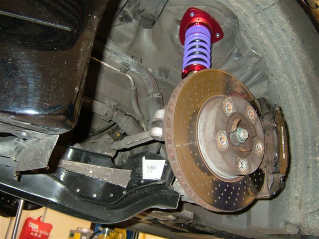

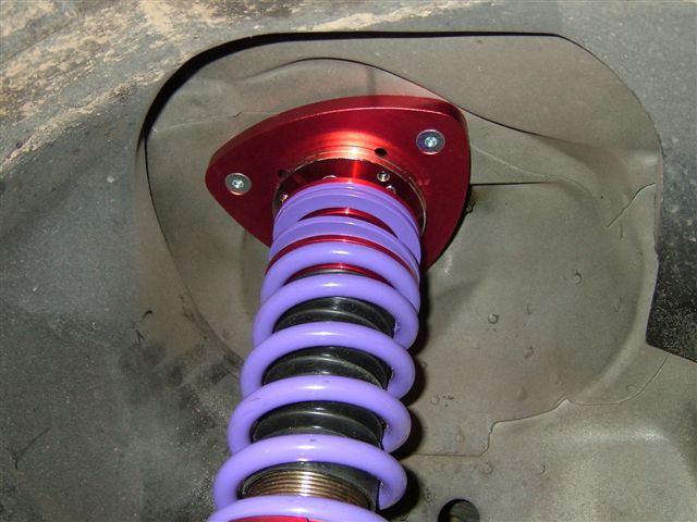

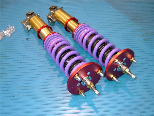

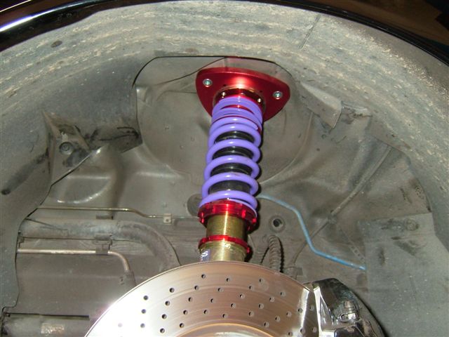

SubscribeSo this project 996 is on its way to being more and more of a DE car (the owner has a street 996 as well lol) so we went back and forth on suspension choices. Motons, whilst being a great track set up are a bit out of range price-wise and the PSS9s are on the soft side for the track. X74 and M030 were going to be too soft and offer no real levels of adjustments that the owner wanted. So we settled on JIC/Cross, which I hadn't done a lot of on C2s (we do Motons or PSS9s usually). We'd had some success with them on TT/C4S before but after having played around dialing it in I must say I'm pretty darn impressed. Certainly stiffer (we went with the "medium" springs) than PSS9s even on the medium settings (15 dampening settings in all). Adjusting camber with the camber plates is a good idea however there's no real room to do that when they are mounted to the car (unless you cut away more of the chasis). You really need to drop the strut to get good access. Mating them up with some GT3 sway bars makes it interesting so can play with understeer and oversteer too.
Another thing I really like about these is the "detense" when adjusting the dampening. There's much more "feel" too it and you can actually hear a "click" unlike with the PSS9s which I think have rather poor detense. I spend a good bit of the time on the phone telling people which settings to use only to find that when the car comes in they're about 3-4 clicks away from where they should be due to the poor detense described.

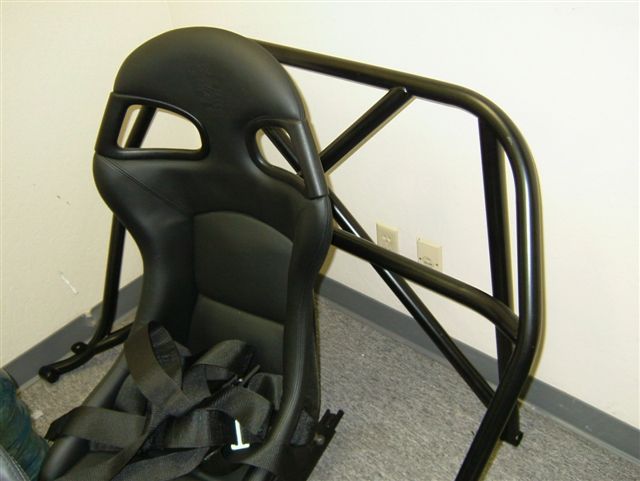

So far this car has the GT3 seats, schroth harness and the GMG roll bar, which I must say according to the owner's experience and my own (I have one in my TT) really did give the car some additional rigidity. It's much more of a "real" bar than the Porsche Tequipment one. More cross bracing, much better mounting (more solid for sure) and thicker all the way around. It's not fun getting into the back but hey... I don't know if GMG is a sponsor on here but you can either get those from them or me. The install is a little tougher than the Tequipment one so be ready to use some brute force

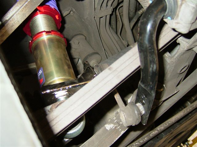

One thing to NOTE: If you're going to use GT3 sway bars you WILL need different drop links in the front. The geometry of the stock ones will NOT work.
