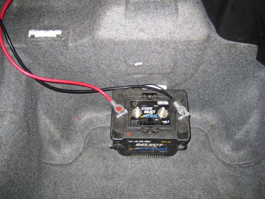

Got home from work and the Braille battery holder had arrived.
Sharkwerks had done their magic and came up with a low center of gravity solution for the battery already. Note that the battery sits just about 5 inches off the ground in this set up. The Exide battery they used is a sealed and small battery weighting in at 35.2 lbs.

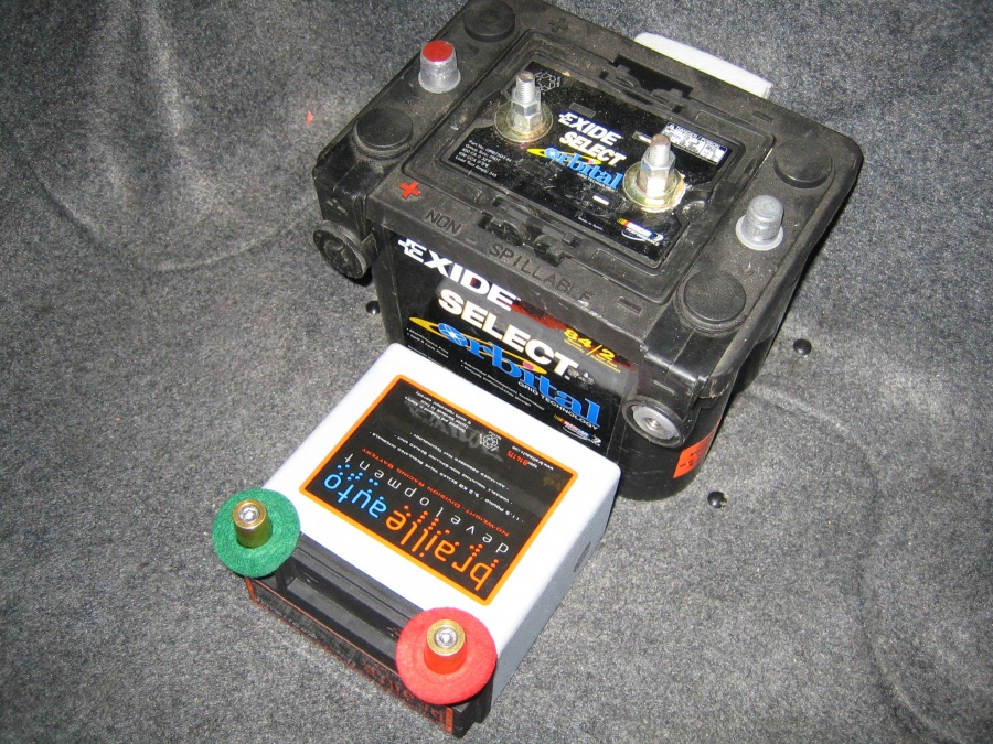

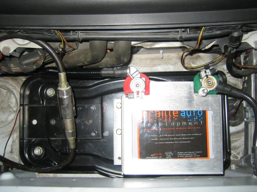

I am switching to a 11.5 lbs Braille battery.
Since it is much smaller and lighter, I am going to move it back in the original position.

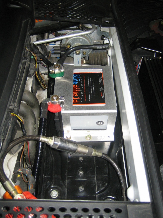

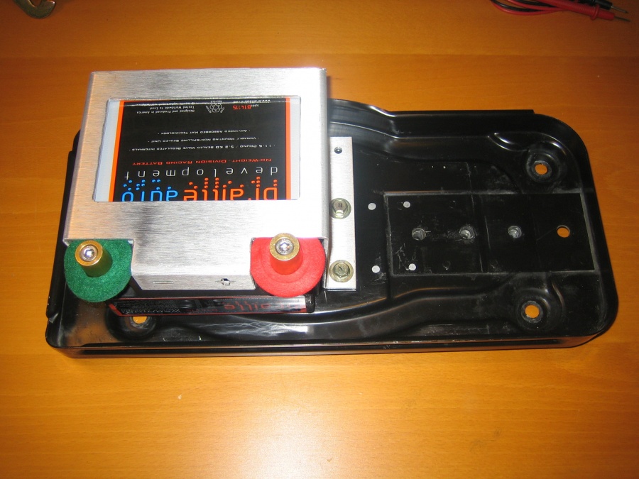

I used the Braille laydown aluminum mount. I also got new original Porsche postive and negative wires.
Here is the battery mounted in the Porsche tray. Drilled holes in the tray, bolted the Braille mount down, then tack welded the nuts to the pan so I can just remove the mount/battery as needed without taking the whole assymbly apart.
Old Jul 1, 2009 | 11:44 PM
  #381
rotary rocket's Avatar
Joined: Jul 2007
Posts: 360
From: Moraga, CA.
Rep Power: 34
rotary rocket has a spectacular aura aboutrotary rocket has a spectacular aura about
The ground wire was not long enough to allow me to move the battery to the left side of the tray. Miner point to try to offset the driver's weight, I know I'm being too ****...
I think the final results are pretty clean.

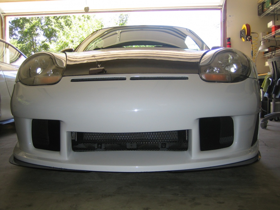

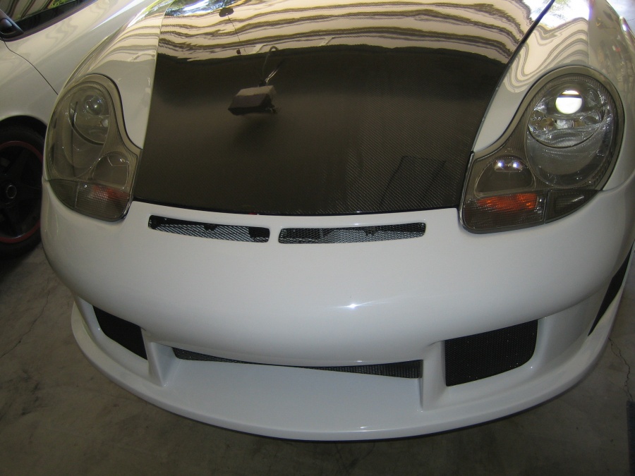

The next mod is going to be front splitters. Here is a before picture for starters.

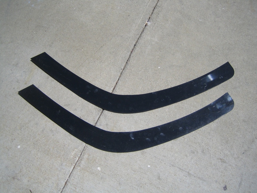

I bought these splitters from a member on this forum. They are meant for turbo front bumpers, so I had to get creative on the fit. They are made of hard plastic.
I attached them via some self tapping screws. They are very secure

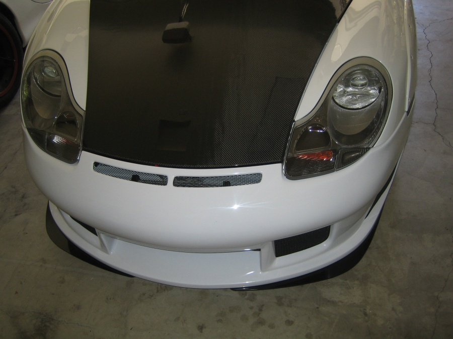

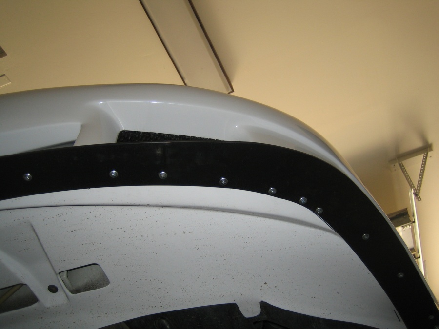

Here is the finished results. Subtle, but should be functional.
