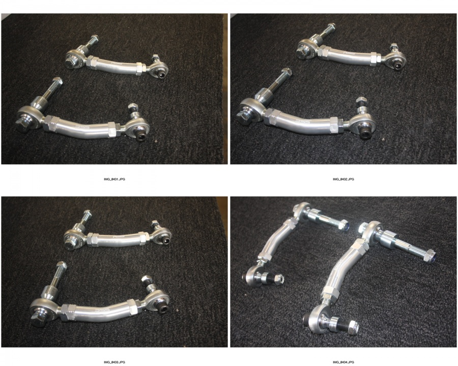

I just received my RSS dlinks today and will be installing them tonight. I spoke to Alex at Sharkwerks and he did mention that the recent B16s come with different dlinks. I'll post pics of the new RSS dlinks.
Old Aug 14, 2009 | 01:53 PM
  #35
NeilM's Avatar
Posts: 925
From: Mountain View, CA
Rep Power: 78
NeilM has a reputation beyond reputeNeilM has a reputation beyond reputeNeilM has a reputation beyond reputeNeilM has a reputation beyond reputeNeilM has a reputation beyond reputeNeilM has a reputation beyond reputeNeilM has a reputation beyond reputeNeilM has a reputation beyond reputeNeilM has a reputation beyond reputeNeilM has a reputation beyond reputeNeilM has a reputation beyond repute
RSS drop links
here's are pics...
