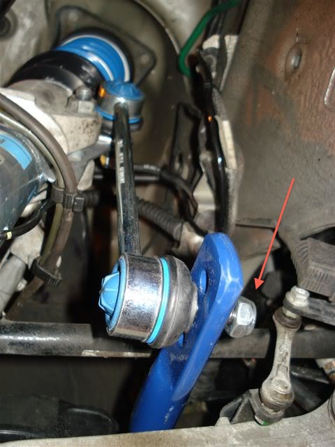

After confirmation that my installer forgot to install the all so important OEM "washers", I decided to pull the wheels off and see if the my drop links were installed correctly... To be honest I still am not certain after looking at the posted pics & diagrams posted so I went ahead and made a short video with my iphone in hopes the experts here can tell me if they are or if I need to take the car back once again.
I also still hear a popping sound while driving up the driveway with the steering wheel turned all the way so just a bit paranoid. And maybe a dumb question, but are the coils normally loose like this when the wheels are off

your dlinks are installed incorrectly to the sway bar. They should be on the outer end(closer to the wheel) of the sway bar. The noise you hear may be the sways hitting the control arm when the steering wheel is in the locked position(turned all the way to the right or left).
Once you correct this, the noise should be gone.

The arrow points to what Neil is talking about...it should be on the other side.

Alex, did you know this screw is loose? Or was the photo taken during your setup/install?

So basically driver side needs to be swapped with passenger side? Or does it need to flip upside down?
Just want to get my facts straight before I call the installer again
