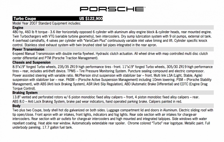

Originally Posted by bbywu
As Chris stated, PASM is a standard feature on all 997 turbos.

All 911s, since the introduction of the 997, have PASM available. It is a standard feature on the Turbo, GT2, and GT3. The only car that I believe had it as an option was the standard Carrera, and I think it became standard after 2 or 3 years into the model.
The advantage of an electronically controlled damper is the ability to change the settings (2 way on the 911, 3 way on the Cayenne) without stopping the car and exiting the vehicle to access controls. Manually adjusted dampers offer a greater range of settings, which have varying effeects depending on the springs you chose. An experienced suspension shop can give you pretty good advice.

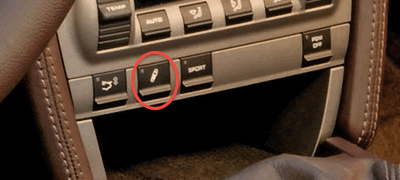

Originally Posted by TTdude
Sorry for going in circles here but since my car is non-SC optioned, I don't have the ability to electronically change the two-way settings you describe. So techinically are you saying that a non-SC optioned car has PASM but is not able to access the toggle function or does PASM do more than just allow one to electronically control the settings?
Do you not have a suspension button?
