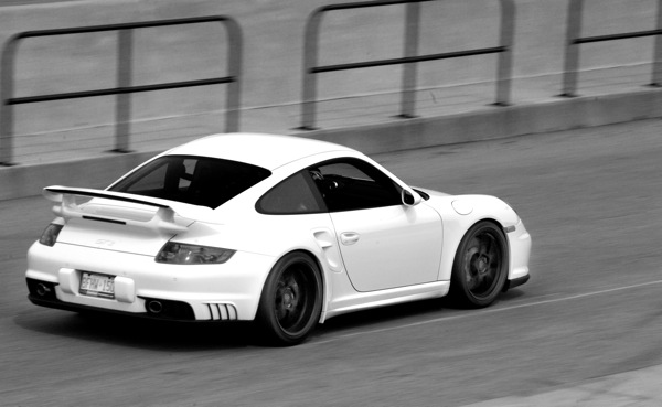

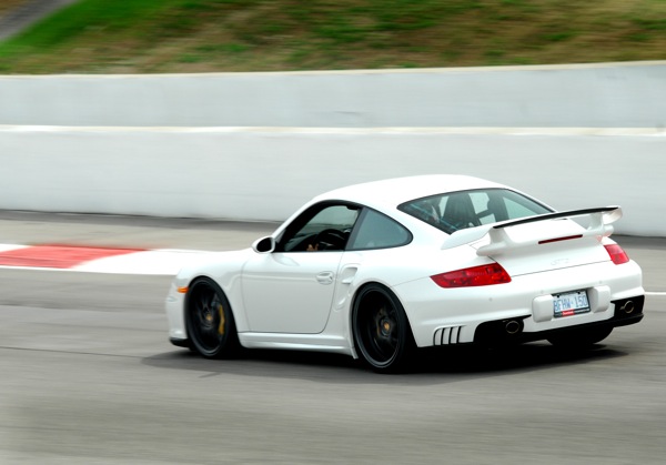

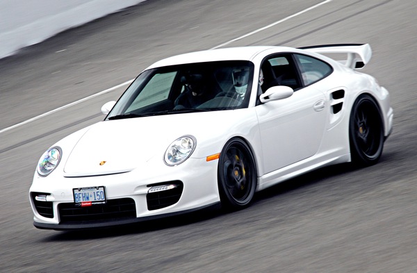

I am sure it would be a problem if you go to low but you can lower it 8 to 10mm with no problems, if you go more say 15mm you will need to get the bumpsteer toe arms.
