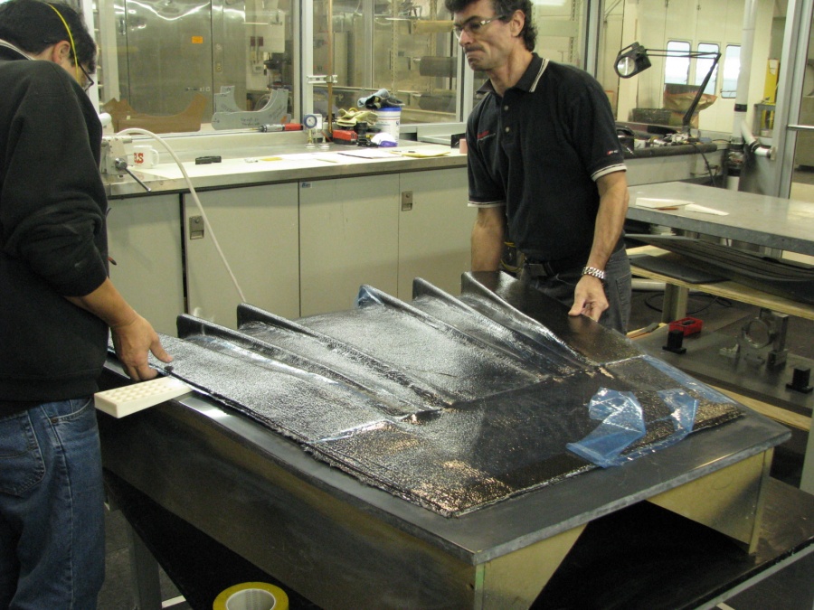

I decided to drop these photos into a new thread, rather than continue to confuse the turbocharger thread that I originally mentioned this new Diffuser in. For those that did not read the Turbocharger thread, there are photos of the mold under vacuum in that thread.
With the completion of this 2010 rear diffuser, we are now able to offer a complete Champion Motorsport aero package for the 997.2 Twin Turbo. We have the front splitter, rear wing with end plates, and now the rear diffuser. All of these components are constructed of the highest quality Pre-impregnated carbon fiber materials, vacuum bagged, and cured in our "in house" computer controlled curing oven.
All of these components have been verified in the wind tunnel, and are proven performers in regard to downforce and more importantly, aero balance.
The photos below are of the de-molding process of the 100% carbon fiber mold that will be used to produce the finished product.
I thought it would be interesting to show this process, as many people have never experienced the "behind the scenes" of carbon production. I also video taped the "de-molding" and after editing, I will add it as well. Once we put the mold into production, I will add a few photos of some actual parts being pulled from it.
Enjoy..

Here is a Video that we put together during the demolding process.
As soon as we have them I will post a video of the demolding of the finished part, as well as the fitment to a 2010 997.2 Turbo.
