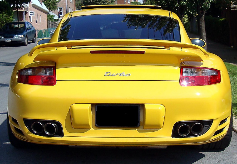

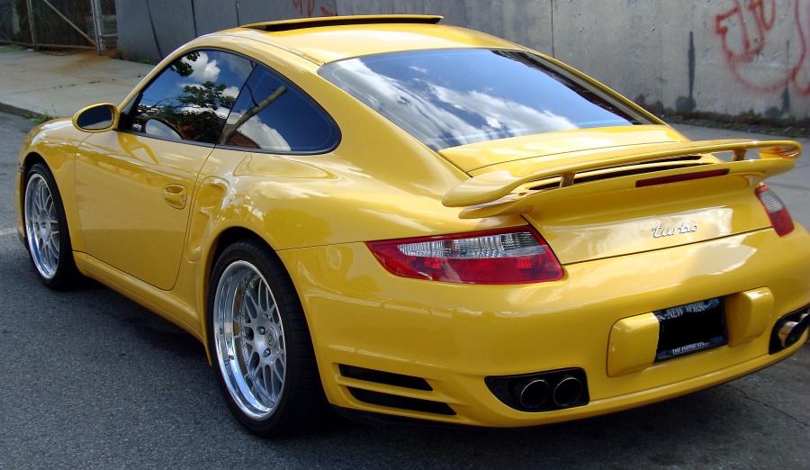

slawek's Avatar
Posts: 680
From: NEW YORK
Rep Power: 74
slawek has a reputation beyond reputeslawek has a reputation beyond reputeslawek has a reputation beyond reputeslawek has a reputation beyond reputeslawek has a reputation beyond reputeslawek has a reputation beyond reputeslawek has a reputation beyond reputeslawek has a reputation beyond reputeslawek has a reputation beyond reputeslawek has a reputation beyond reputeslawek has a reputation beyond repute
YouI'll need to loosen entire exhaust, to set right and it should fit,See pics.
