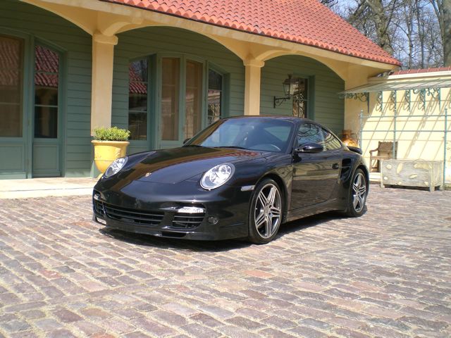

Thank you for taking the time to respond. At least this gives me some direction, and hopes I might still be able to keep this exhaust. New territory for me and the learning curve seems a bit steep right now. In the meantime.......some pix (but don't know why they only show as thumbnails).......

Boy I love a black car when its clean and shiny!!
