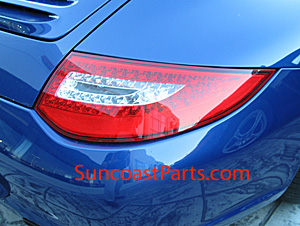

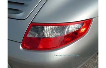

But they are different sizes - round peg in a square hole. Here's what the Porsche dealer says:
NOTE: Significant bumper modifications required to fit this set, consider upgrading to the new style rear bumper (see related items below) to complete the upgrade. After you figure out how you're going to fit the fixture, you might look for the wiring harness/adapter that FVD sells - save you the trouble of splicing wires. 997.2 on the left and 997.1 on the right.
