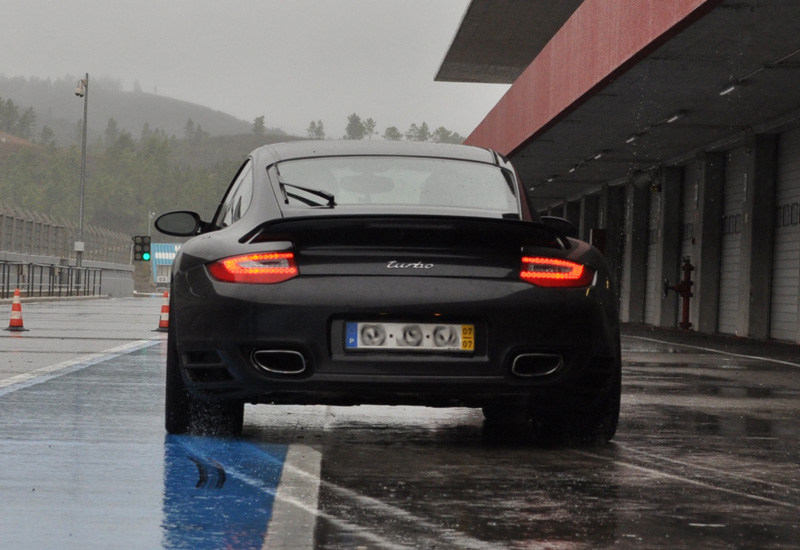

Originally Posted by w00zy
This thread helped lots of people. Me included.
I bought a complete used bumper in ebay for 550€ shipped. (Seller was Techart, they usually have lots of oem bumpers)
New led tail lights and FVD controllers were 1388€ shipped
New 997.2 bumper bracket was 30€
The FVD controllers are a bit expensive but it's plug and play and reversible.
There are other controllers that are cheaper but you need to cut existing wires. (Didn't knew about this option at the time)
997.2TT exhaust tips were 600€
It needs new exhaust or modify the existing exhaust for the new tips. I went with a Europipe special made for new bumper and exhaust tips.

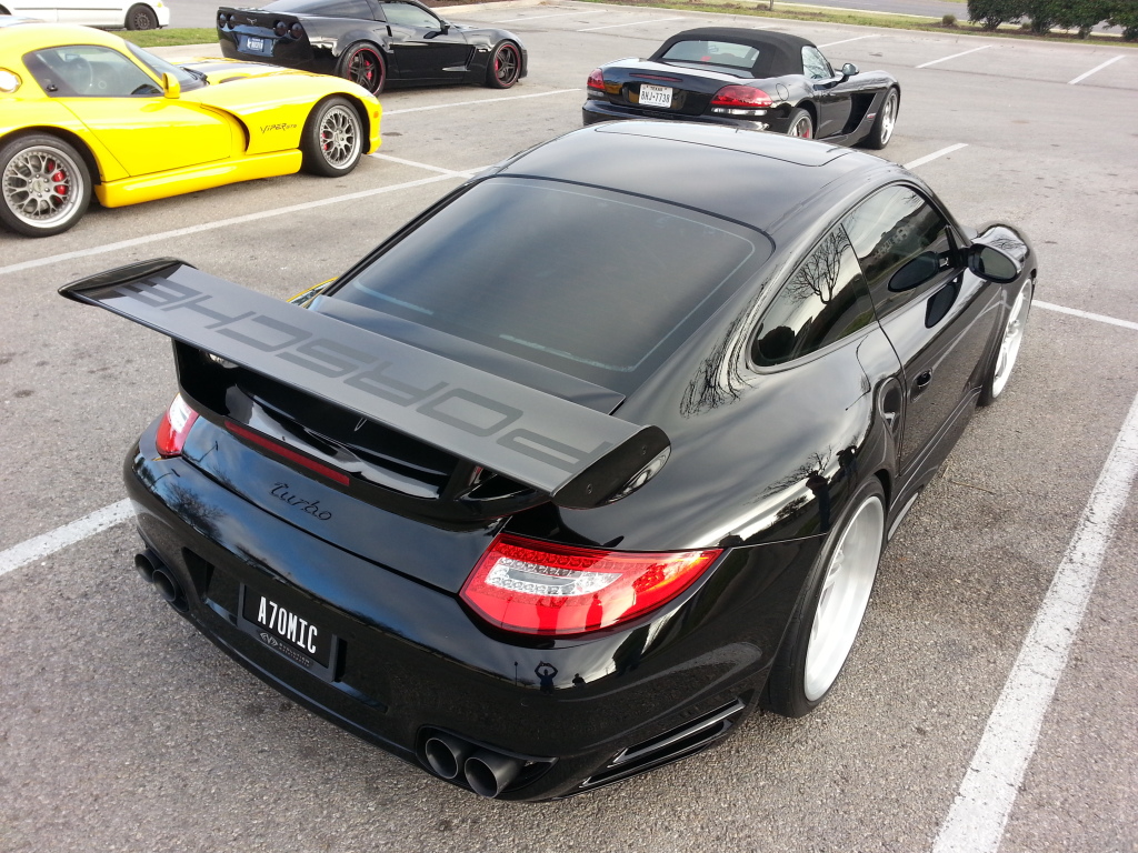

Kinda cool my 07 has the same mod AND the same (kinda) plate as OP.

Very nice. Did original bumper have the back up sensors or did you add with the new bumper.
My car already had the sensors and the bumper that i bought had the holes. I adapted the sensors like atomic80 did, without buying new brackets.

Lol! Almost the same plates as mine! Funny. That wing! Omg!

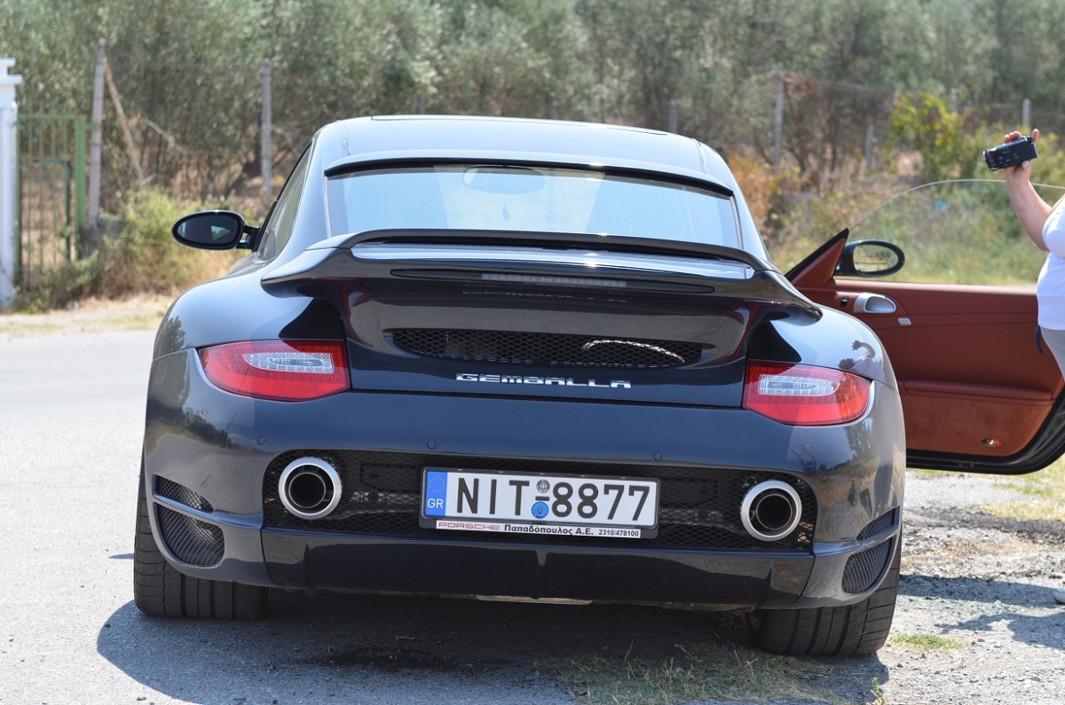

And here is my Gemballa Gt550 with the same light conversion but with the Gemballa bumper.
