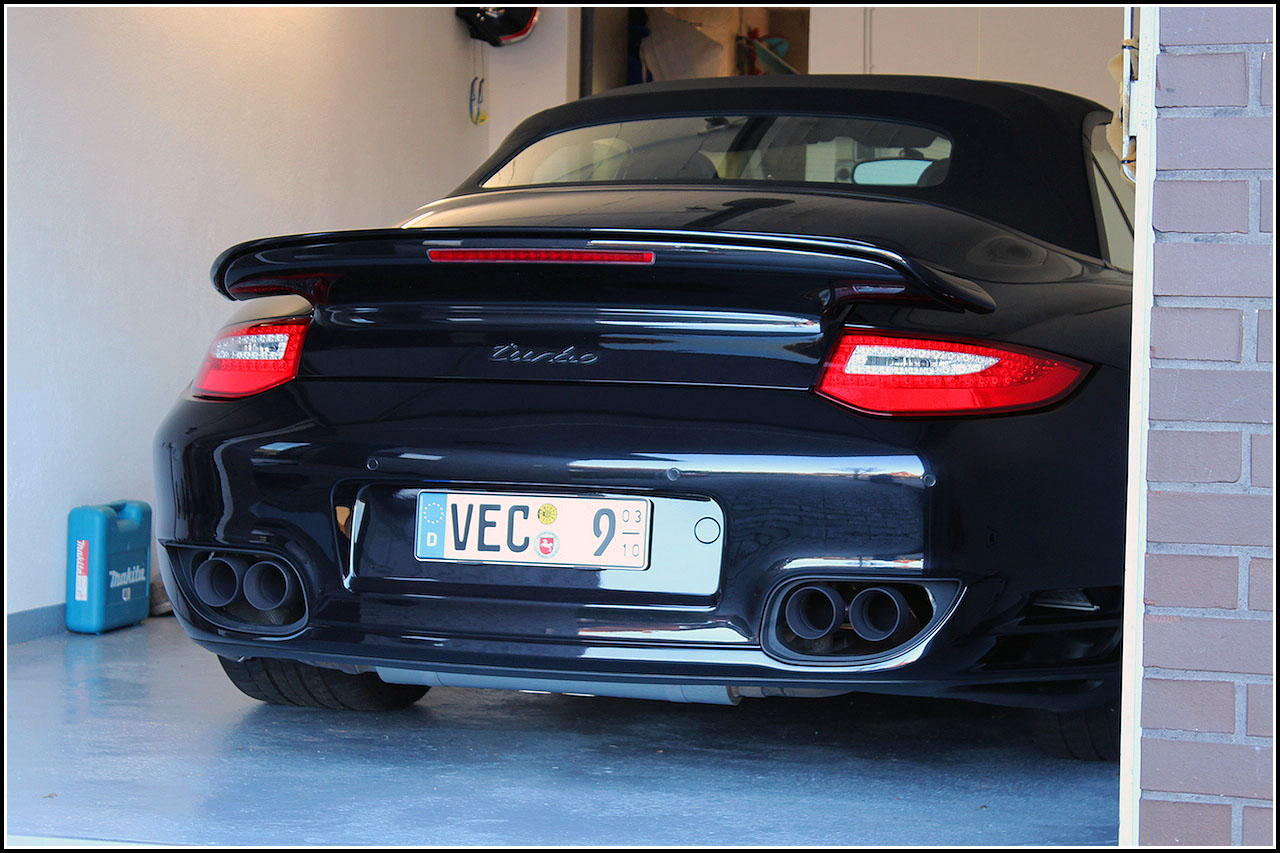

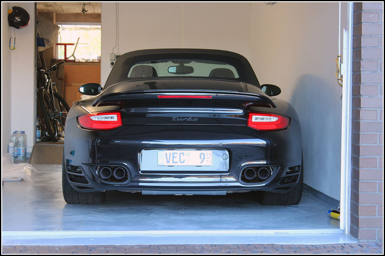

Hello guys,
I am from germany and we have a 08´ 997 Turbo Convertible. I did the LED taillight swap a few weeks ago. Yesterday the missing front module (997 618 513 01) arrived (the rear module already was the right one 997 618 260 08) and I connected it to our car. Additionally I changed Pin 11 to 36 and Pin 42 to 31 on the blue connector of the front module. Everything is working now except the fog lights in the front. They didn´t work
I have a Piwis, so can a wrong PIWIS configuration cause my problem? Did anyone have this problem, too and know a solution for it?
Regards Gregor

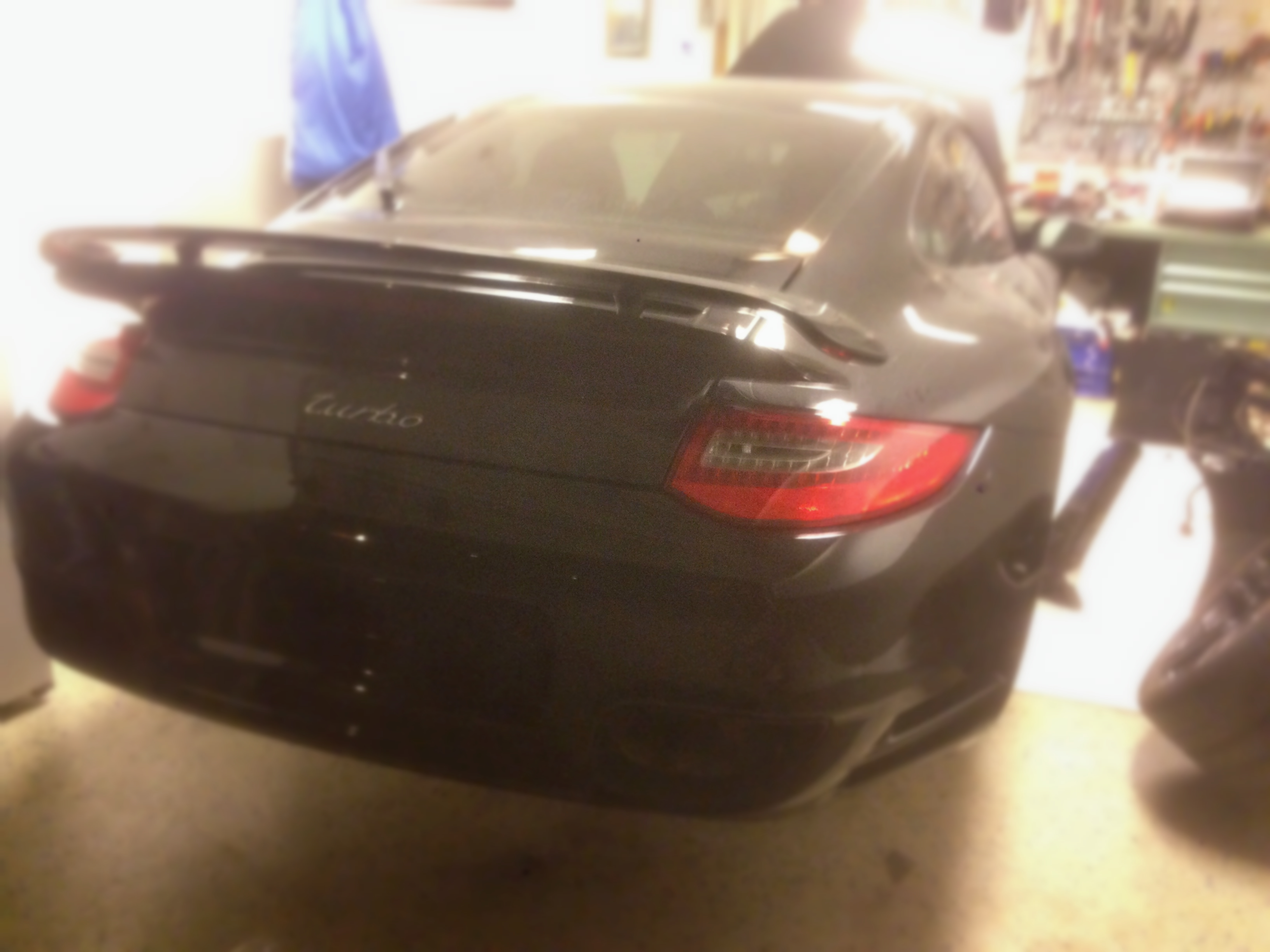

Soon finished...
