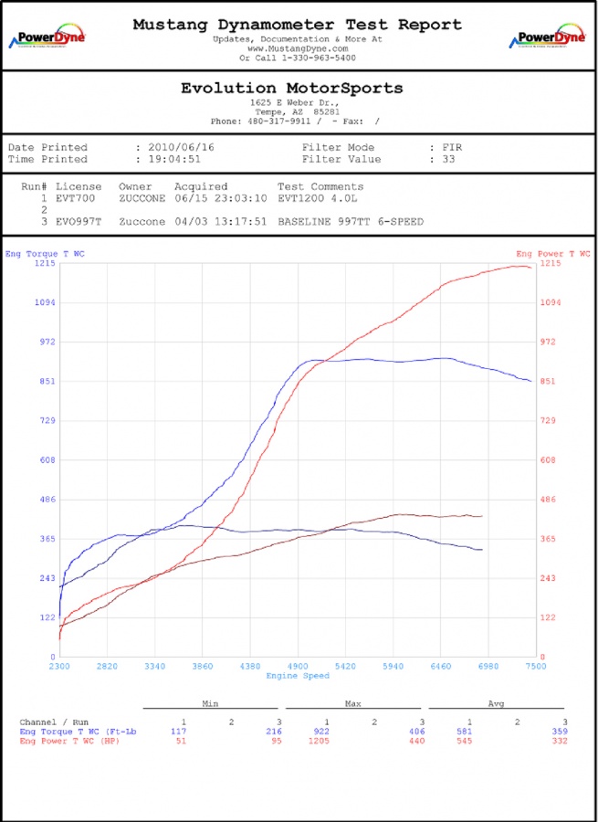

Here are the details on the engine build:
https://www.6speedonline.com/forums/...ls-inside.html
Attached is the dyno. The dyno does not tell the whole story about this engine. Once we get all of the components installed, we will be spinning it to 9000 RPMS. Right now we are cutting it off at 7500 RPMS. We will not have all of the other components done for the mile but we will set the rev limit to 8000 RPMS to try and achieve our top speed goal.
