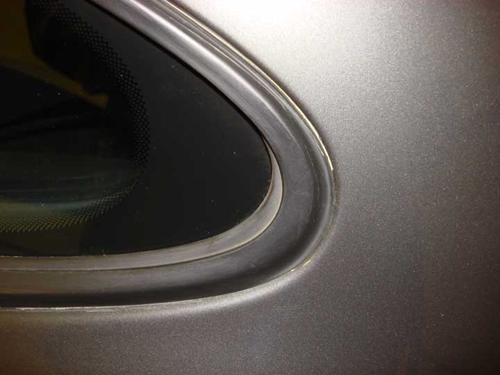

What do you guys do? Here's a photo, it is a very sloppy wax job in photo (cold weather when I did it, no rubber conditioner) but just to illustrate.
I'm afraid to use a soft toothbrush to gently remove this excess. I'm thinking someday when the light is just right, I'll see crappy abrasion and scratching along these rubber trim meets paint areas if I do.

Maybe Swissvax has something by now?? I hate taping up a car, but I hate removing wax residue worse!

You can ask the fellas over on our detailing sub forum for suggestions, too.
I tape for 2 reasons...you showed the first reason - wax in the creases. The second is for polishing - the paint tends to thin toward the edges of sheet metal. It prevents me from over polishing the corners.

It looks like a little to much product honestly. I wouldn't apply wax into that area, I'd work up to the edge that's it.

Def need some vinyl protectant, VRT fr Adams is great and not greasy.

Yes. Thanks. Will check it out. I use Vinylex but it was (I was) too cold to use it last time. Looks terrible I know! OUCH!

Just powerwash all the creases after you finish. Just stay further away from the rubber than a normal crease(bumper meets fender etc.) a good power washer can burn moldings if too close
