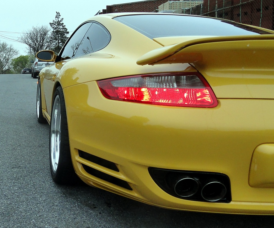

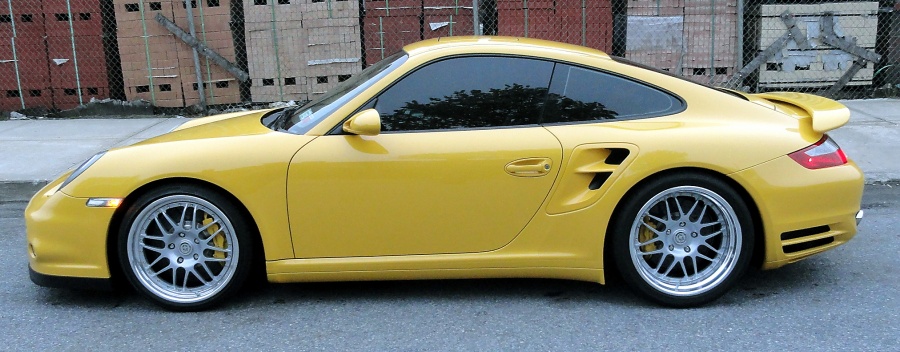

Guys, here are pictures of car after Bilstein installed

Looks nice. An avatar change perhaps?
