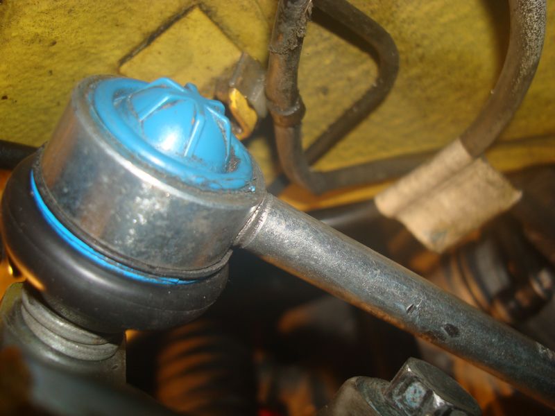

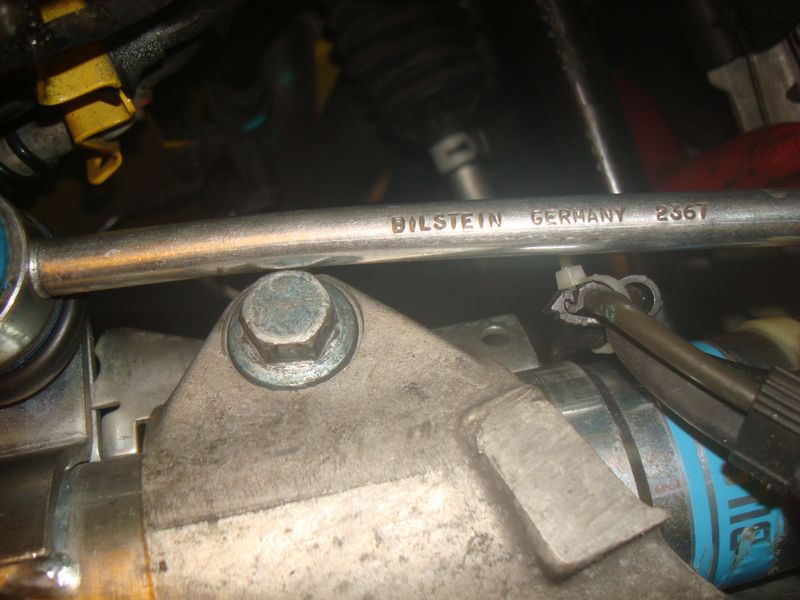

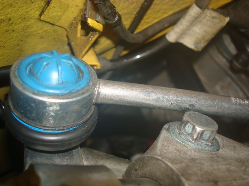

Did some test drive and noticed some strange sounds in my front suspension. So back to garage for checkup .First thing I noticed was the right lowering link was touching the head bolt on the wheel carrier when turning the wheels all the way to the right. What I did I install some extra washers (4 mm. in total) to push the lowering link away of the bolt. This allows for link to pass the bolt without any problems Just to keep everything equal I did the same on the left site as well. Went for the test drive and surprisingly I still found some strange clicking noise in the front. It took me more the five hours of test driving and checking everything in the front suspension to finally discover the problem. You see after the car is lowered the whole geometry, position and the stress on the suspension changes. My wishbone (lower control arm) needed to be tighten where it meets with the cross member. Did some more spiritual driving-testing on the most uneven and bumpy roads I could find in my neighborhood, the car was quiet. Now, I was ready to set the height, a very time consuming and painful process.

-make sure your front links don’t touch the bolt on the wheel carrier

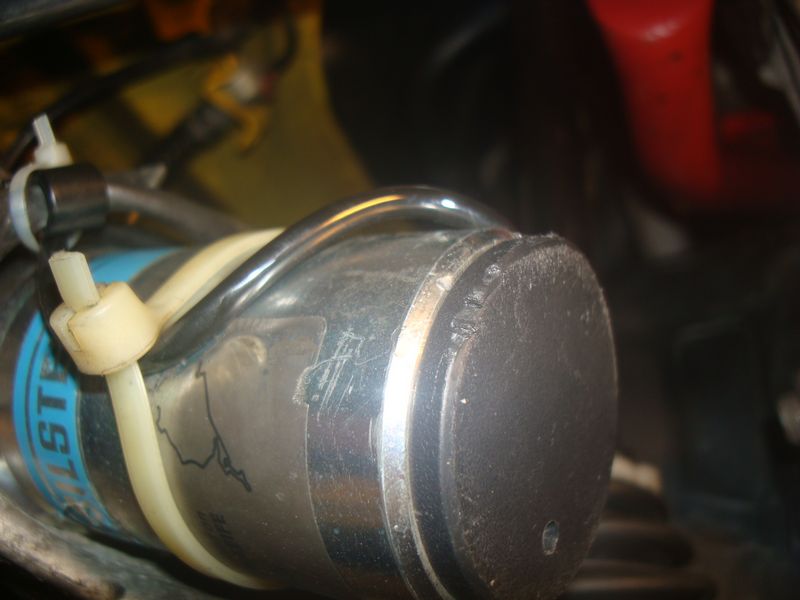

-take extra time to secure pasm wires

Attached is the pictures of the link (before and after) install with extra washers

Yes, it's a big job, and a PIA DIY. Tarret, among others, offer suspension spacers, essentially washers that do the same thing. Might consider flipping the drop ling mounting point med/lateral to get the correct geometry.

Hi Doug, I did some heavy driving couple of days ago and at my settings they work great enough flexibility in the suspension for me to feel safe and in control of the car.
Only think that Bilstein should change on them is the pasm wire in the front shocks .I think it would be much better if the wire would cam out of the top ,or if not they should use only one wire without the additional extension. coming from the bottom
And that's the achilles heel of the Damptronic, even the slightest trauma to the base of the strut causes a terminal PASM failure. Only a thin plastic cap "protects" the PASM wires from damage, and potentially causes damage during some installations by crimping the wires.The only cure is replacement of the entire strut body. I'm quite sure the location of the wire is purely a cost move for ease of packaging the system for other applications. Had they just followed the OEM lead they would still be on my car.

Doug, I actuality installed another cup under the black one (now I have two) to secure the wire , you can't see on the picture but it is inside and used heavy-duty electrical straps to secure the pasm wire.I've checked different heights and can tell you that anybody who set Bilstein Damptronics in front at below 25.5 inches is asking for trouble.
