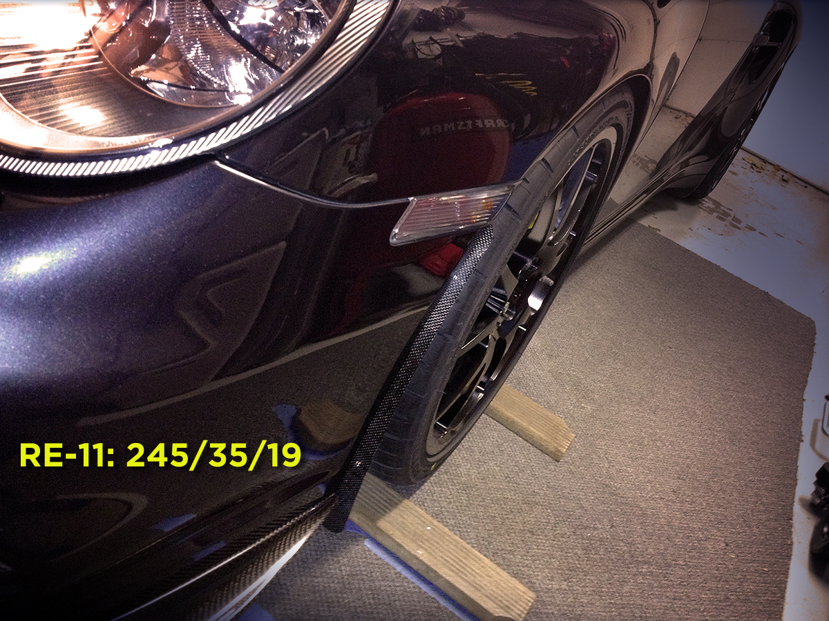

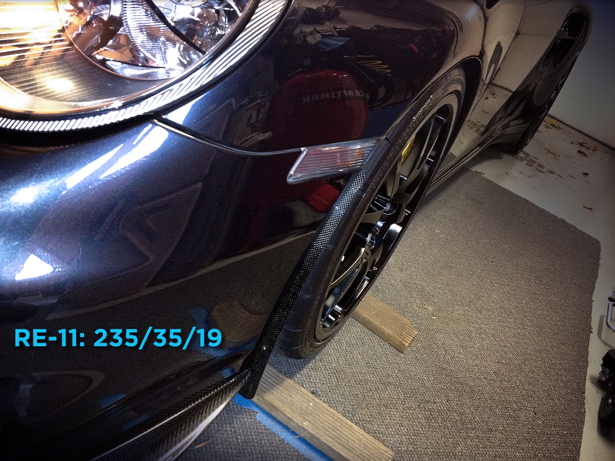

The RE-11 245/35's ended up fitting quite nicely up front. We were a little concerned about the fit/rubbing while running a 7mm spacer, however it wasn't an issue. You can see in the photos below the comparison between the 235 vs 245. Most noticeable, is how flush the 235's are with the rim face compared to that of the 245's protruding out board about 5mm. These 245's have a more similar fit/sizing of my Hoosier R6's 235/35's. Although when running the R6 235's I have to remove the 7mm spacer and use shorter lugs. That's how much wider the R6's really are.
Even though I mentioned next time I would try a different tire/make....I think I will try running the RE 325's in back once available...then move onto something different...gotta explore the options.

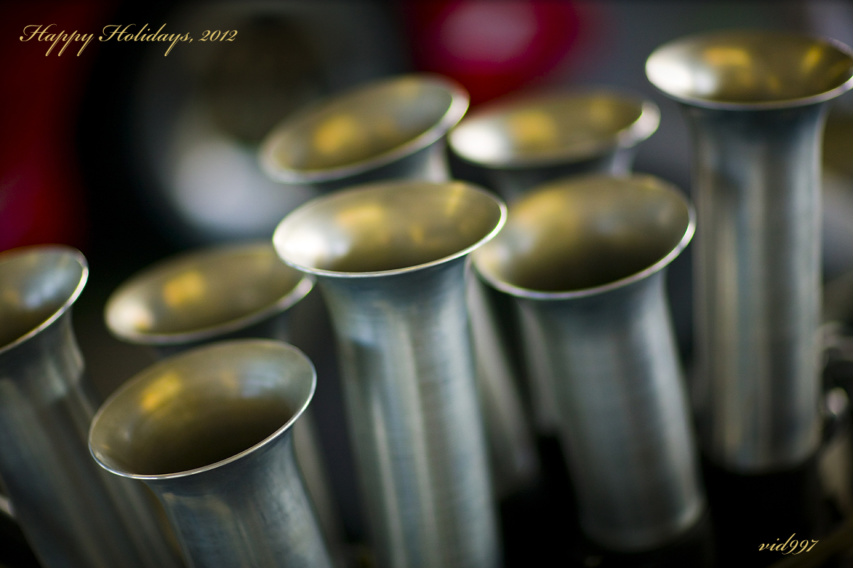

A look back at 2012. Shot in the middle of summer in a completely natural environment and no post work. This image just says "Seasons Greetings" to me.
Wishing you all a wonderful Holiday Season with family and friends, as well as the very best for 2013!
Cheers,
VID997
IMAGE: 1972 McLaren M8FP shot in the garages at Sonoma Historic Motorsports Festival June 2nd, 2012, Sonoma Raceway.
Canon 1Ds
Lens: Canon EF 85mm f/1.2 L II USM
Shutter speed: 1/250
Aperture: F/1.2
ISO: 160

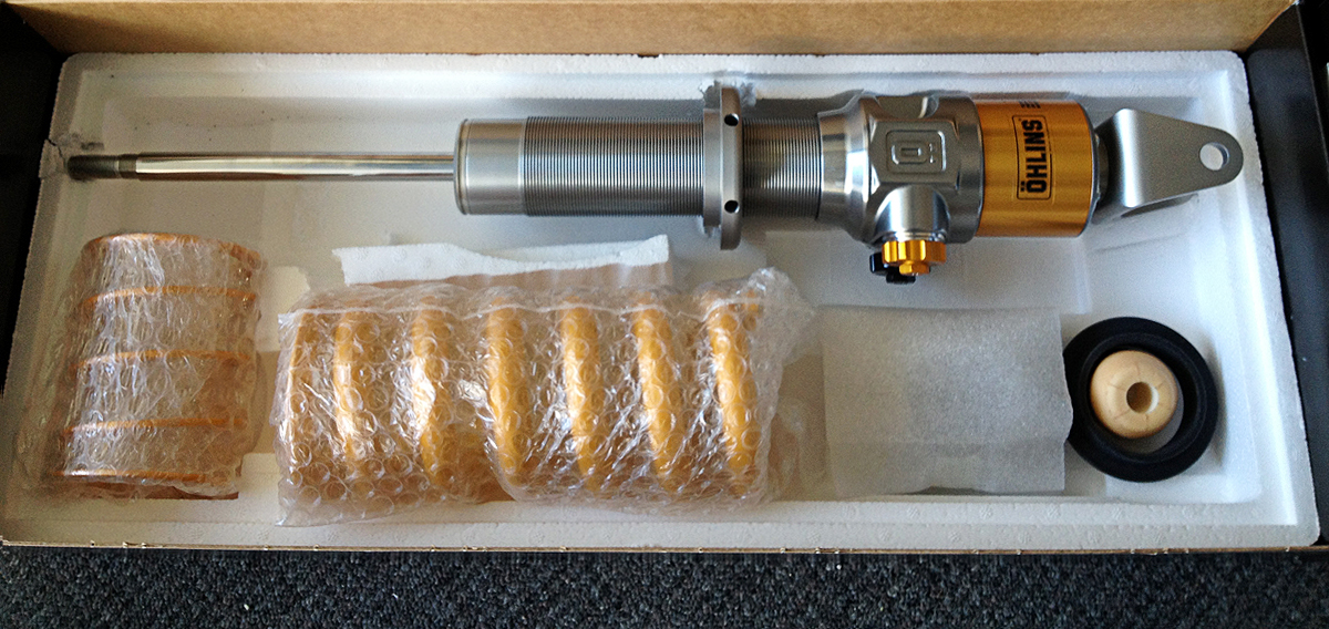

Good things come to those who wait.....
2013 upgrades are starting to trickle in. I'll try and take some ore pictures before dropping these off for install.

Man...D, that's gonna be sweet! Is it dual stage like the damptronics or a single setup?
