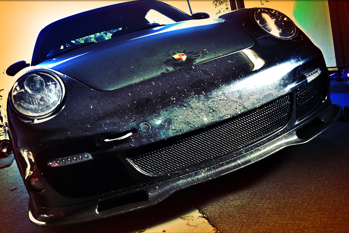

Buttonwillow Aftermath: This is what my car looked like today in the garage after two days of "on track" action at BW, plus the drive down and back up to SJ. I spent over two hours vacuuming out the interior. I can't even imagine what the cars must look like that had "offs"!. Don't think our club had any off on Monday, but SV probably had 5-10 a session, per run group! Crazy....what a dust bowl down there.
Enjoy your weekend!
