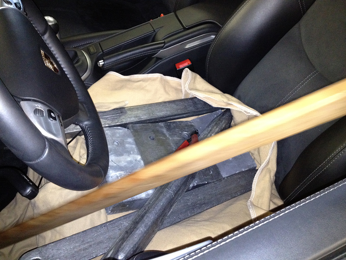

JWE did drop a 160lbs of lead in the drivers seat while doing the alignment and "squaring" the car.
