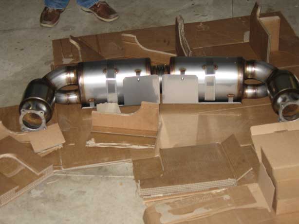

I ordered a Europipe exhaust for the TTS about two weeks ago. Stef at Europipe was a pleasure to deal with. He kept me up to date on manufacturing and shipping progress. The system arrived on the date promised. When I opened the box, I found the exhaust, studs, nuts, specialty tools, anti-seize grease, wires for fishing through the O2 sensor cables, and even a box of Belgian chocolates.
I'm a mechanical engineer in the pharmaceutical industry, so I've seen thousands of orbital weld in stainless steel piping and equipment. The workmanship and quality of the welds on this exhaust system rivals the best.

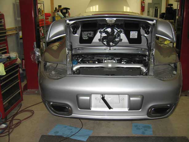

Stef emailed installation instructions and detailed pictures for the R&R. It took me about seven hours to do the work, and I wasn't rushing.
The rear bumper came off first. (two people recommended). I had to cut the wires and install a connector for the rear laser shifter on my Escort . The rear heat shield and rear fender well liners came off next. Then both intercoolers came off, as well as the upper intercooler induction air hoses. Then the side heat shields came off.
Stef had supplied me with wires to tie to the O2 sensor wires, which were used to fish through the O2 sensor wires on reinstallation.
The next part was the second most challenging- unhooking the O2 sensors from the myriad of clips which secure them.
Finally, off came the exhaust tips, muffler straps, and the nuts securing the exhaust to the turbos. The special 12mm wrenches supplied by Europipe made the nut removal easy. I was lucky, as the studs did not come out with the nuts, but Stef supplied me with a new set of studs just in case.
The OEM exhaust was lowered to the ground, and I removed the O2 sensors (with a wrench supplied by Europipe). Luckily they came loose without heating.
The installation was pretty much the reverse of removal, with the addition of anti-seize on the turbo stud nuts and O2 sensor threads. The hardest part was fishing the #&** O2 sensor wires back through and connecting them to the clips.
One of the most important parts is to make sure that the induction hoses fully seat and lock into the intercoolers.
The new exhaust sounds great. no drone in the cabin, but a great low pitchgrowl outside the car... until you floor it in sport mode- then all hell breaks loose and you get this great symphony of roaring melody.
Just a subjective impression, but the turbos seem to spool up faster and the car feels quicker. it certainly sounds better.
I can't say enough about the customer service focus of Stef and Europipe. His installation instructions and tip were invaluable. and he's just a plain nice guy. Answers your questions, checks up on how the install is going. The quality of workmanship the exhaust is superb. I feel that I really got what I paid for- it's not just about price, but about value.
I've attached a few pictures of the car during various stages of the install.
