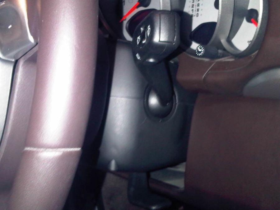

I dont have CC. Here are some pics of the steering column.

i thought cruise control stalk is on the other side of the steering wheel..?
