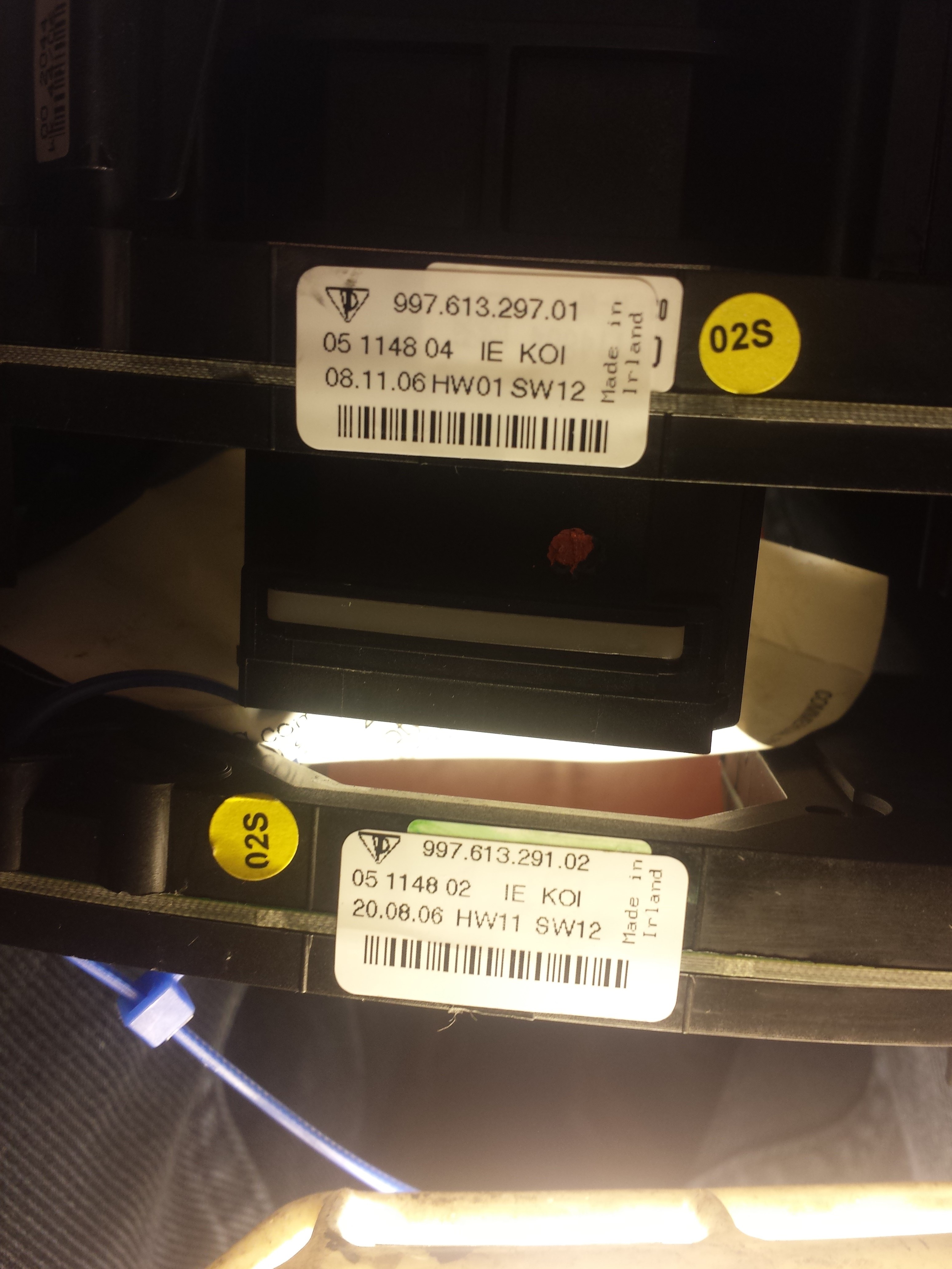

but the things is my triangle airbag has the film type plastic socket and the new circle airbag has the metal type? how will i convert that my film type socket to fit the circle airbag?
you should post pictures so we can see what you mean by that. The wheel and airbag are a matching pair.
sorry sir.. im new to this forum and i have been trying to upload pics but sad to say my attachments cant be posted.. would you mind if il ask for your email?
the 997.1 Turbo steering case?
the upper picture is the new style wheel so if that's what you are installing you won't have the ribbon cable. That's from an older style set up. The newer module is identical to the one in the car now but will accept pdk programming. The module is under the stalk and clockspring towards the dash. Hope that helps.
