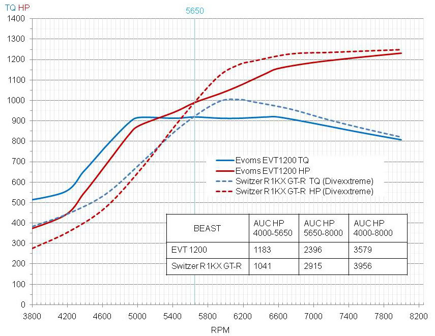

Updated....I think you're ready for The Mile.
Note: Both based on Mustang Dynos. EVT 1200 data was extrapolated from ~7450-8000.
