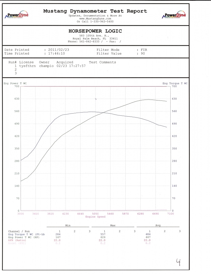

Tom, would you have the data to give to Dave to plot the curve on pump gas with the 68 setup? I can't find the damn dyno plots right now but I recall that the graph you showed previously demonstrated a large dropoff with pump gas above 4k rpm (like it would with pretty well any setup I think compared to race gas).
Here's both dyno graphs...for comparison. I'll try to see if I can dig up a run on pump gas, in case there's not direct correlation. There's not much of a difference in power, because the turbos are being held back...with pump or race gas.
Tom, this was the graph I was thinking of. I realize now it's for the 65mm GT2 version, if you have the same graph for the 997tt version of the 68 please post it. Is there a difference on the compressor side for the GT2 version vs the 997tt version of the 68 or 65 billet turbo? I understand that the turbine (hot) side is different for GT2 vs 997tt. BTW, thanks for all the info. I've been meaning to rep you for it and finally did.
You're right, that graph you posted is from a set of our 65mm Billet turbos we did on a GT2 a while back. The reason I posted the other graphs is because our dyno here at the shop is a dyno-jet, which requires us to remove the from driveshaft and run in 2WD. We don't really use it so much for publishing power results, but more as a tool for tuning. Our final tuning is usually done on the Mustang AWD dyno up at an independent shop called Horsepower Logic. Everyone used to scrutinize us so much when we posted 2WD dyno charts so I usually stick to the 4WD but I attached another one for you from the one of the recent 68mm upgrades we did. It shows 3 graphs, one for each of the GIAC modes... pump gas, race gas, and stock. The "stock" graph is not totally stock, it's just GIAC stock mode with our hardware installed.
As for the turbine housings themselves, we usually stick to whichever turbo came off the particular car we're working on. In other words, if we're working on a GT2, we use GT2 turbos. For a standard 997....997 Turbos. However, since we always have cores in stock we offer the GT2's as an upgrade to guys with standard 997's. Right now I've got about 5 sets of our turbos on the shelf so there's never a wait time.
