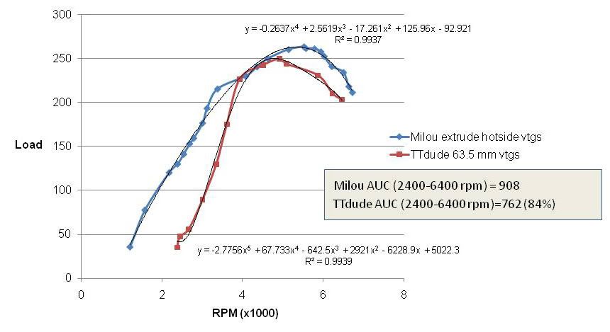

Tom, Would be willing to share your datalogs and let me graph it? All I need is MAF, IAT, and RPM. You wouldn't be revealing any timing, afr, or boost. What do you think? Dave

Absolutely. I asked Louis to pull one of the logs from the recent 68mm upgrade we did here last week. I showed him the formula and this post, and he was really intrigued by the concept. Of course, with all the million things he had to do yesterday to get ready for his races this weekend, he forgot and he's out of the office today. I'll make sure I can get it for you Monday. Remind me in case I forget..lol.

Dude,
What about some data from 63,5mm VTGs with extruded hot sides ?
Just give me an email

Sounds great. I'm sure folks would be interested. Thanks!
Originally Posted by milou
Dude,
Sure, would be happy to. Will send email.

Dave, I'll send you my tune datalog and you can compare it to the vtg one.

Hi Asher, Send me whatever you got. I'll plot anything. I can even add a fudge factor and make it look nice--LOL. Your AUC will be looking really good.

Milou's third gear pull with Tip. He's running mafless so I used Load values. Looks like your extrude hotsides paid off! Nice low end gains with some gains up top as well. Thanks for sharing bro. Your car must feel really sweet.
