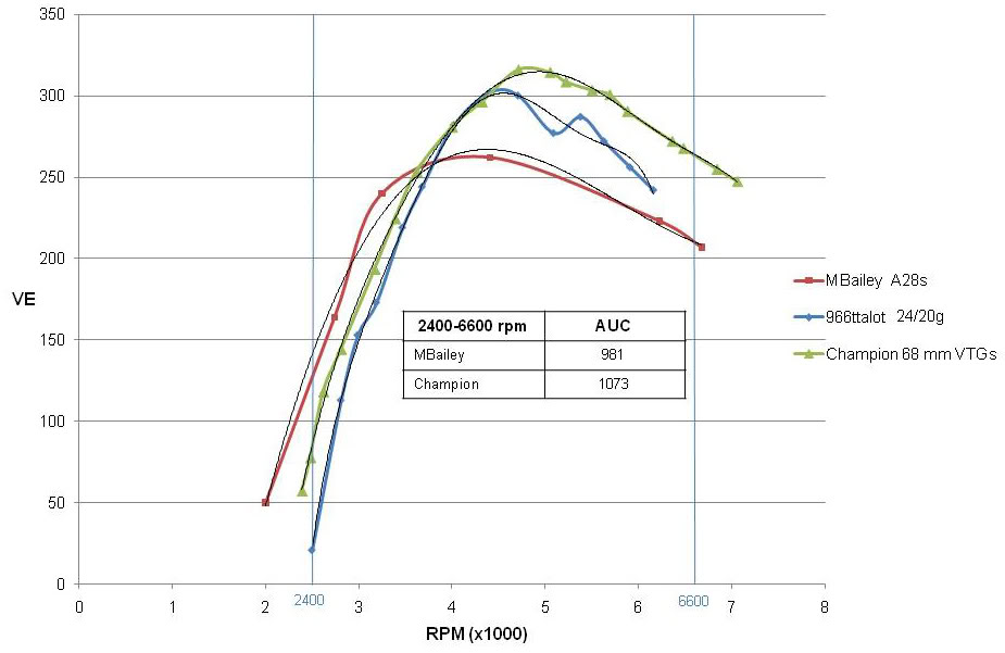

Here you go Tom. Looking pretty good. My AUC for the same range is 742.

niiiice result with the 68mm VTG!!!! I presume again that it's a 997tt hotside and not GT2 hotside and that it is with racegas. I must say that this is something I'm keeping my eye on since it can be used without external controllers etc......

Tom, Thanks again for sharing your data. There was note on your log that read "Important note: CMS uses modded MAFs in our kits so the MAFs kg/h and voltages given are rescaled for our tunes." Would you mind clarifying this because it's important that all the MAF readings are actual values for apples to apples comparisons. Dave

Interesting data with the 68mm VTGs!
They really have great pull up top, especially for a VTG.
Kudos to Champion!
I hope to be sending a new datalog next week. Todd Z has written a new file which hopefully will give me some extra power up top. We shall see...
Oh...let me translate Louis' note there. OK..so basically on any of our 68mm VTG kits, we always use our carbon inlet pipes (they're required). With the combo of the two, we also use modified MAF housings to allow the MAF's to increase their range. The particular datalog we sent you was from a car that had the stock MAF housings in place so that you could make an apples to apples comparison to other cars. I hope that clarifies it a little...

Thanks MBailey. I'm tellin' you....you guys HAVE to feel how hard these VTG's pull! With essentially 200 less HP then other kits, they're SO much faster! Tial hit it out of the park when they did the final engineering on these. Keep in mind...we are actually holding these turbos back at this level. They have room for more.
